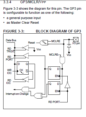

My 2nd Question is :
How to utilize the comparator action in my program. Instead of a stable 1 at output, I need to output a square wave to drive a buzzer using any other unused pin. So that I've added the following 2 lines:
switch (GPIO.F2) {
      case (0) : GPIO.F3=0;
      case (1) : GPIO.F3=1; delay_ms(500); GPIO.F3=0; delay_ms(500);
but got no output on GP3 regardless the comparator condition. Is there another idea ?
O.K. second chance at it, GP3 (MCLR) is input only pin, try GP5. Or use GP2 by setting up the CMCON register for no output.
GPO3 is input only
Yes, I've used GP5 as output and got everything working fine. My buzzer is sounding whenever it is dark. My next step is to immigrate the same program into a larger PIC such as 16F6XX and 16F7XX and try to test all their comparators and let you know my progress.
