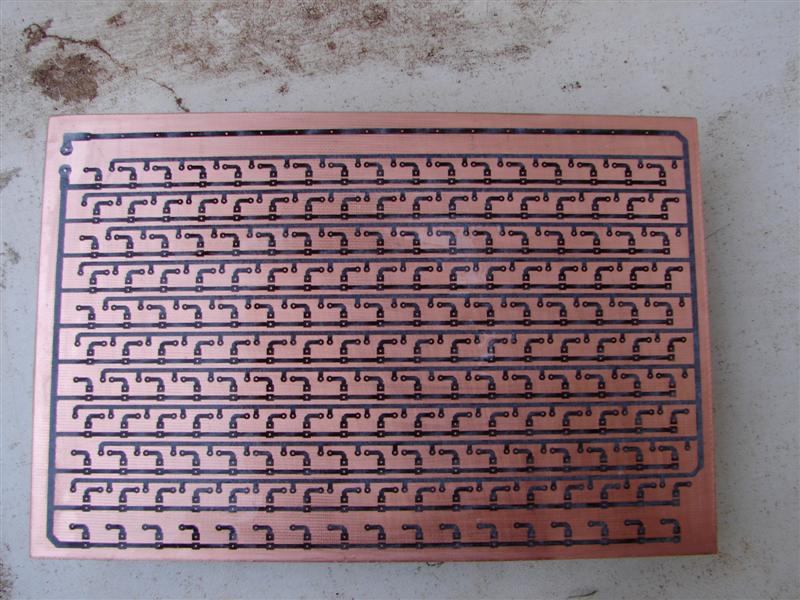

I've always been using toner transfer on magazine paper to make PCB's, but that's hard work. I decided to give photo resist a try.
Attached are 2 pics of small test boards I made. The circuit was printed on 120gsm tracing paper using a laser printer. The thinnest tracks are T8 size (the smallest Proteus will do). Exposure was done with good old sunlight @ 1 minute 10 seconds. Very happy with the results.

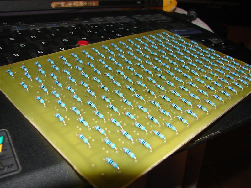

The 3rd picture is of the UV LED board I made, still waiting for the 200 LED's I ordered before I can give it a go.

PS: Making the UV board was also the first time I used carbide drill bits, and after 750 X 0.8mm holes the same bit is still going strong, only slightly starting to lift the copper on the edges of the holes... think it is still good for at least another 200 or so holes... worth the money.
