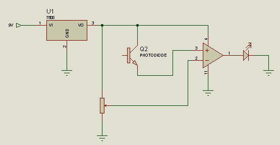

i bought today a LM2901 comparator... and it works.... but the output voltage is not the V+, it is <1V
why?

That circuit seems lacking in many of the essential components, I wouldn't expect it to work at all!.
comparators typically have open-drain outputs. that is, for a low output, they pull it to ground normally, but for a high output, they act as an open-circuit. you need to use a pull-up resistor with it most likely.
