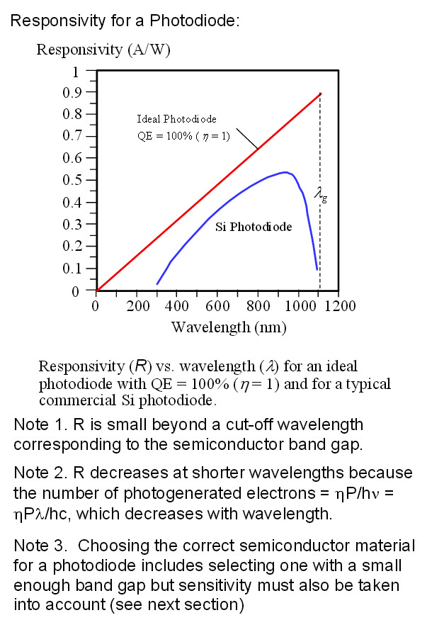

Hi
It's understandable that when wavelength increases, the responsivity of a photodiode decreases. But I'm confused that the responsivity also decreases as the wavelength decreases; at lower wavelength the photons are going to have more energy. Why would responsivity decrease with decreasing wavelength? Someone has told me that as energy of photons increases, their absorption probability decreases. Please help me. I'm using **broken link removed** reference.

The long wavelength side has a sharp drop off because of the semiconductor's energy bandgap. At some point the photons just don't have enough energy to make the transitions that would generate a hole-electron pair. On the other side, you might have less absorption in the semiconductor (allows the light to pass through), opacity of window/lenses, reflections, scattering loss or any of several other effects that could reduce conversion efficiency. For example silicon makes a good photodetector over a wide range that includes some UV, all visible and IR below 1000 nm, but above 1000 nm the band edge kills it and it is useless (unfortunately) for 1300 nm and 1550 nm communications systems. Germanium goes to higher wavelength and some of the III-V and II-VI semiconductors can extend even further.

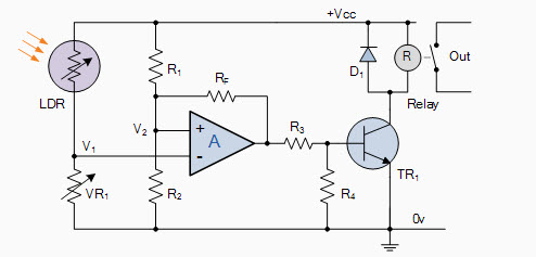

I think as the resistance of LDR decreases, the relay will be turned off, and as the resistance increases the relay will be turned on. Do I have it correct? I'm using this **broken link removed**. Thanks.

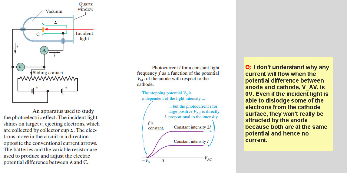

OK, for the photoelectric effect. You'll want to study the full effect to understand the whole conduction curve, but answering your specific question is easier.
If the potential is zero, then you will realize that those electrons would just like to get back onto the conductor, at any point, and usually at the nearest point. Since the potential is the same over the entire conductor (anode, cathode and wires), the electrons are happy to get back on at any point. However, the electrons are emitted with kinetic energy and get launched into the anode cavity. So, they will prefer to go back on the anode, more often than on the cathode.
Yes, you have it correct. The relay will be energized when the resistance increases beyond a particular threshold level.
All of the LDR's i've ever used have a decreasing resistance with increased incident light. So the resistance gets lower with increasing light intensity.
