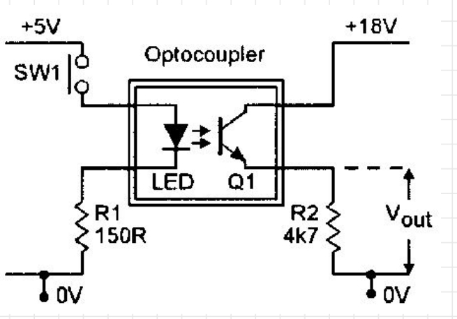

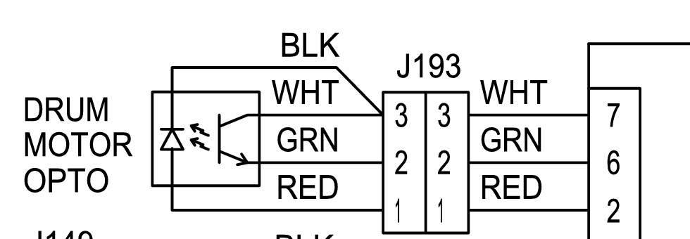

My current issue is reading the drum speed sensor - a slot type photo interrupter. The schematic has the following detail. I don't think this is correct, as the negative side of the LED is connected is connected to the collector of the NPN transistor. (which most types of photo interrupters seem to be.) Is there any way this illustration makes sense.
The second illustration shows the circuit as I think it should be.

I don't know. It's located deep in the machine. Getting to it requires pulling out the motor which requires driving out several pins.
Hey the light direction is backwards too but then it has only 3 wires and is shown with "positive logic", Light on = +V out.
Green is ground
Red is current limited say 10 mA e.g. +(5V-2)/300 ohms
White is pulse out 3V optical open, 0 V blocked. ( with no pullup) If schematic and results are correct. add 10k~100k Output to ground.
If "negative logic" then use a pull up on output. Blocked light = +V out.

I have the OEM board (which I an replacing/upgrading) in hand, so I'll trace the connections to find my error.
I think I have this figured out now, after tracing out the board. When looking at someone else's design, the question often is "Why did they do it this way?"
The LED is connected to the +24V source via a 1k resistor. The transistor is in series with the LED (which explains why the connections seemed wrong. The junction of the LED/transistor is connected to ground via a 1k resistor, which puts about 10mA through the LED when the transistor is off....and the junction point should be roughly 12 volts.
The emitter is connected to ground via an 18k/10k voltage divider, which will result in a pulse of ~ 5V.
I guess this circuit design will make a short pulse, as the LED current drops to near nothing when the transistor switches on?
On second thought, the LED stays on when the transister fires....so I don't entirely get why they did it this way.

Fortunately I've found the error in my circuit. All of the dozen or so sense switches in this machine are supplied 24 VDC and the output goes through a 39k/10k voltage divider to provide a 5v signal when activated. Why change what has worked for 30+ years?*
I my haste to get the boards made before the tariff insanity started, I didn't study the encoder circuit in depth and figured 24v sensor supply --> 24v sensor signal, so the 39k/10k divider should work great.
The 18.8k/10k voltage divider provides about 5v from a 14 volt signal. With my 39k/10k divider, the output is less than 3 volts with a 14 volt signal. Swapping resistors should solve it.
