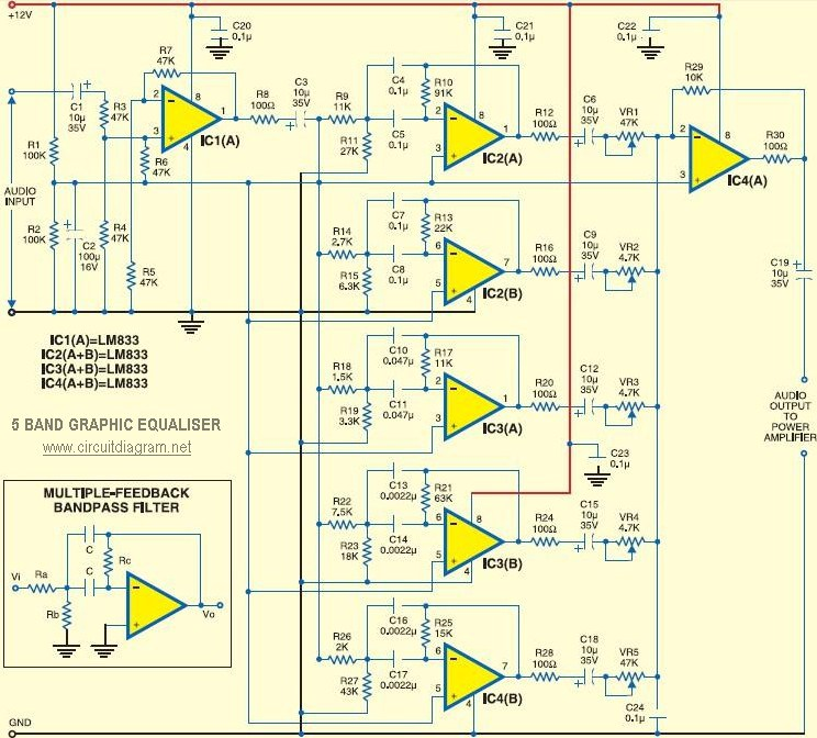

Hello everyone,
I am new to filter design and I want to design an audio equalizer. I used Sallen key topology design calculator from:
https://www.changpuak.ch/electronics/Sallen_Key_Bandpass_light.php
I designed five band bandpass filter having simple low pass and high pass for initial and final bands.... The problem is that when i use a summing amplifier to control gain and get output, i get very poor graph for frequency response with depressions which i think is due to phase shift of different bands interfering with each other.... I summed the individual gain of bands with respect to frequency and i got fairly smooth response.....
is there any way i can remove this phase shift??? or get normal output??
Please Help!!
https://i.imgur.com/UMwEvlX.png

I did a search for 5 band equalizer:
Note that each filter has the same number of op-amps/ same type of filter/ same .....
I do not know you answer!
It is strange that you have filters with 1, 2 or 3 op-amps.
There are also filters with a RC or no RC on the output. I only see a small difference. (8%)
I think you want each filter to be built the same way.

Highpass-lowpass Sallen-Key filters are not used in audio equalizer circuits. Multiple Feedback Bandpass filters as shown or Baxandall filters or simulated inductor circuits are used instead.
Here is a classic equalizer circuit using Baxandall filters. https://www.circuitlib.com/index.ph...9-audio-graphic-equalizer/category_pathway-28
Here is an article from Texas Instruments.
https://www.ti.com/lit/an/slyt134/slyt134.pdf
I think your problem is caused by the 2nd-order filters have 180 degrees of phase shift that cause cancellation when added out-of-phase.
yeah, the problem is cancellation due to phase shift.
OK, I am changing to narrow band bandpass filters.. lets see the results.
Just curious. What about chebyshev bandpass or butterworth bandpass filters? will they be any good in terms of equalized audio output?

Ok, I simulated the circuit.

output is still showing peaks. It is also multiple feedback so what is the problem?
Graph: https://imgur.com/EehZVFN
Circuit: https://imgur.com/swOEp3B
Had to do on PSpice
ok, The problem is solved by adjusting Q-factor to produce fairly smooth frequency response.

The article from Texas Instruments I posted says an audio equalizer circuit needs filters with a low Q and they recommend gyrators. Many equalizer circuits use Baxandall "tone control" filters that are single order (low Q) with maximum phase shift low enough to be added without cancellation. Some circuits have one opamp with many filters. Other circuits use an opamp for each filter.
