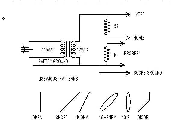

Some years ago I worked in a computer repair shop that had a device called "Huntron" (the manufacturer). It used Lissajous patterns; I think the idea was to measure the nodes of a good board and compare with a bad board (YUCK!). I thought it was a neat device, so I made my own:
