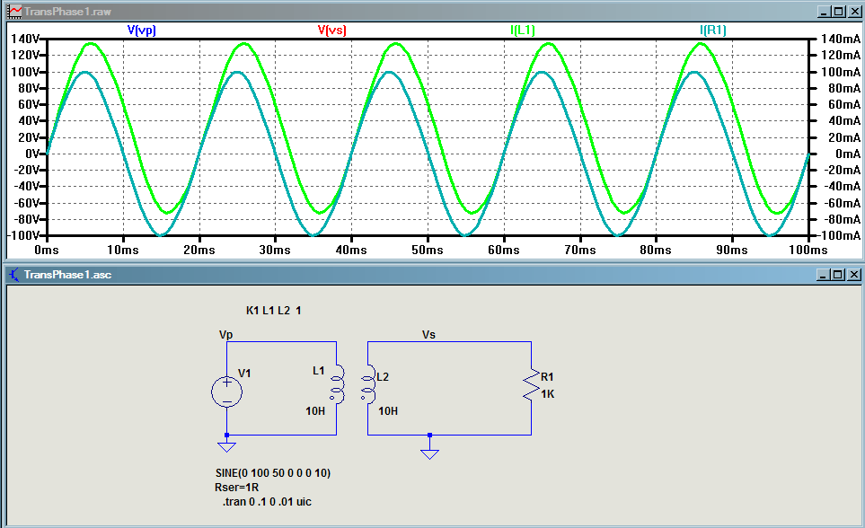

So what the others say?
is there a phase when increasing load?
Look at what LTSpice reports.
Three different resistive loads.

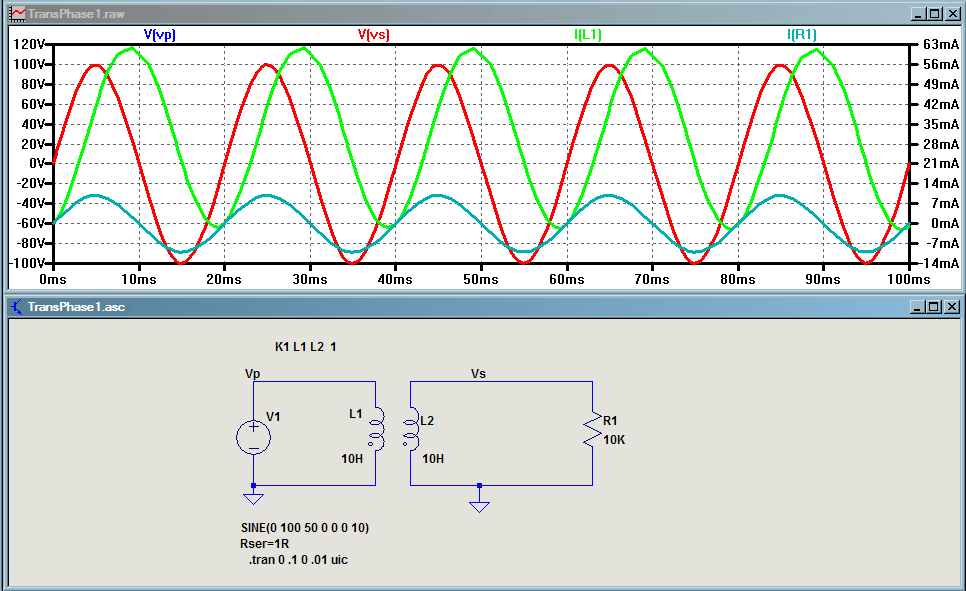

Thank you very much Eric.
In the first picture, you dont see the primary coil's voltage (blue) since its covered by the secondary coil's voltage (red)?
In the second and third pictures, you dont see neither of the coils' voltages, how can you know then that they are at the same phase?
Because they're right on top of each other alphacat. They're drawn as a list from left to right, so if one of the waveforms on the right exactly overlays it you can't see it.
I get it, alright just wanted to make sure, thank you.
I see that the phase between IL1 and Vp is not 90 degrees.
Why is it then?
and what is the formula for IL1 then, if not Vp/XL1?
