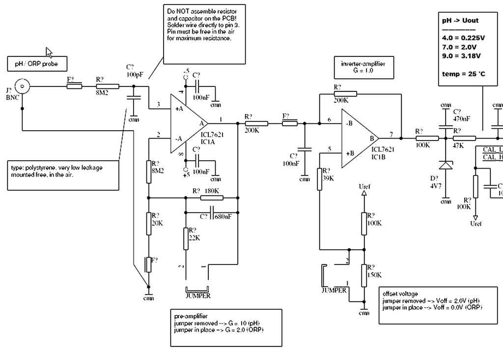

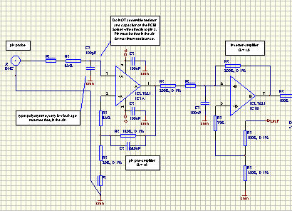

Icl7621
I am also building a pH-circuit and I use the ICL7621 chip. It works fine for me....:)
Kind regards,
Jack
Kind regards,
Jack
Too bad your schematic is too small to see it clearly!
It is too bad the schematic has those awful grid lines and was saved as a fuzzy JPG file type instead of a very clear GIF or PNG file type.
pH amplifier
Hope it's better......;)
Although not very sharp, one can see the application of the ICL7621.....
This is a combined pH/ORP amplifier.
Kind regards,
Jack.
Kind regards,
Jack.
