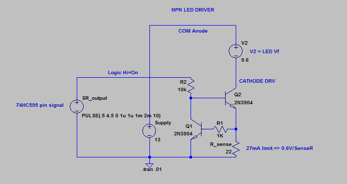

You should not use a 22 ohm current-limiting resistor because you []b]do not know[/b] the actual LED forward voltage and the datasheet does not even say the minimum voltage.
What is the current if the actual forward voltage is 2.8V each? The total will be 8.4V and if the supply is 10.1V then the current is (10.1V - 8.4V)/22 ohms= 77.3mA and the LEDs will quickly burn out.
You should calculate the value of the current-limiting resistor if the LEDs are 2.8V, 3.2V and 4.0V. Then you will see that maybe a 12.0V or 15V power supply should be used.
The spec sheet says the typical Vf is 3.2V. That calcs to a 22 ohm resistor for a 10.1V supply and a 9.6Vf with 3 series LEDS. I can add some diffusing and see if its still bright enough.
NOBODY is going to test hundreds of LEDs to possibly find some "typical" ones for you. Maybe the latest production run did not produce any "typical" ones.
The LEDs you buy might all have a forward voltage of 2.8V or less. Then they quickly burn out if you use a current-limiting resistor with a value as low as 22 ohms.
Ok, I understand now. There isn't a min. spec to use for the Vf. How about driving each 'typical' 9.6V, 3 LED segment with this:
Varying the supply voltage or Vf by a couple volts has little effect on the current. I am running at 30mA as the display is a 2 digit and will share the driver time with a 50% duty. I am planning on using a 74HC595 shift register to drive the segments via this cct.
Dissipation on the mmbt3904 shouldn't exceed 150mW.
EDIT: Are there constant current shift register LED drivers like the CAT4008 for >9V voltages?
Perfect. Use a constant current driver circuit for the LEDs. But R2 should be 1.4k or less because the datasheet for the 2N3904 driver and most other little transistors show that for it to saturate its base current needs to be 1/10th its collector current.
