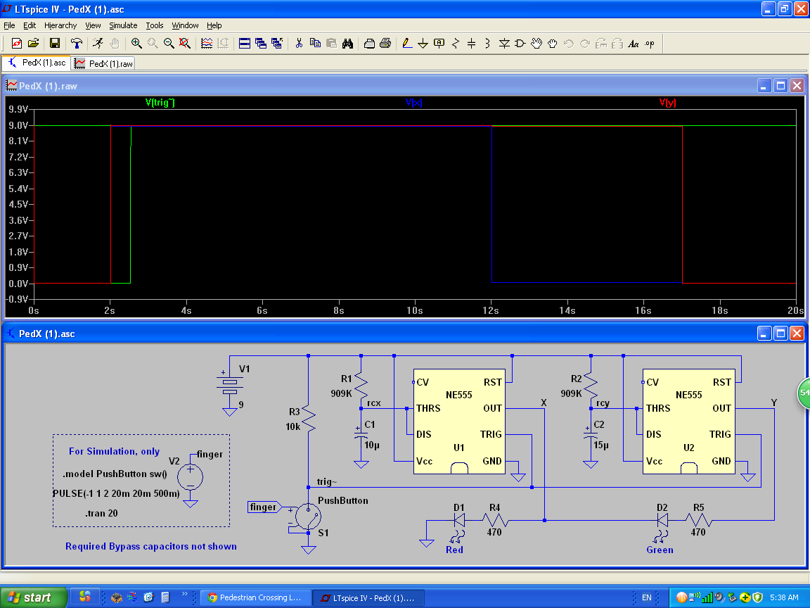

I am attempting to design and implement a digital circuit for pedestrian traffic light in a way when a push button is pressed a red light become on and stays on for 10s showing the activation of the 'traffic light'. Then a green light becomes on and stays on for 5s which shows the pedestrian can pass the street. After that the light becomes off.
I am using a 555 timer ic to control the time the LED's are illuminated for, ( i have sorted the timings) and have been given a NAND ic chip to switch between the two timers so that the green activates after the red. I am relatively new to electronics so do not know how to achieve this, i understand that you can use a NAND chip to create other logic gates but do not know which to create to achieve the results.

If the pattern is this:
All off
Push button
Red on for 10 s.
Green on for 5 S.
All off
Then I don't think you need the NAND gate. Look on the 555 datasheet for the Monostable circuit. The switch and 1 resistor trigger the first 555 set for 10 s through the Trigger input; the output drives the red LED. That output also is connected to the second 555, set for 5 s through a capacitor to its Trigger input and a resistor to Vcc. It drives the green LED.

Now, suppose that the teacher is only slightly more experienced than the student, and THINKS it cannot be done without some NAND gates...
All off
Push button
Button triggers both timers X and Y at the same time, X is set to be high for 10s, Y is set to be high for 15s
Red LED is on while X and Y are both high simultaneously (for the first 10s)
Green LED is on while X is low and Y is high (for the last 5s)
No LEDs on if X and Y are both low.
Can anybody do it with less components than this? Plot the current through D1 and D2.
  • PedX.asc
That was ingenious. ;):D
After the button is pressed. Both X and Y go high from 2s to 12s so only D1 is ON.
After X goes low at 12s and Y remains high, D2 is ON until 17S and D1 is off.
Saves an 4011 NAND.
Allen

D2 is driven by an "h-bridge" :)
