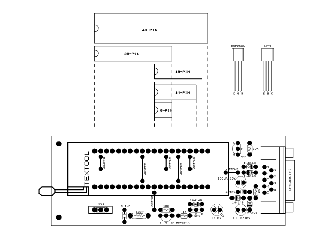

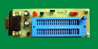

Im trying to adjust this PCB layout for the right scale , but i don't have the ability to make correct accuracy :
here is a PCB layout and real PCB picture :
Any help would be appreciated

Can you print it 1:1 scale on your printer?
Hi. Give me the total measure between far edges and I can use Inkscape to scale it for you.
In return I give you a pdf file in A4 format.
Printing a raster graphic file with correct alignment can be a nightmare. Can your layout program export to a vector format, or even better - print directly from the program?

I only got this : DB9's upper 5 pins , from pin 1 to pin 5 lenght is : 1.1 centimeter .
Can this be useful ?
Sadly, no.
Distance is too short to be able to resize it with proper accuracy. You may find any datasheet regarding the chip (the one with largest number of pins) that tell you about the internal length between pins.
I couldn't find any "DB9" in your images.
From pin 1 to pin 20 is 315 pixels. DIP package pin pitch is 0.1 inches. From pin 1 to 20 that makes 1.9 inches. Calculating from there the resolution of the image is 166 dpi (quite common resolution).
.. so the image size is:
741 x 457 pixels == 4.46 x 2.75 inches.
From corner to corner 5.245 inches
I can't verify that the dimension in this PDF are correct (no printer at the moment).. I hope they are. Make sure that you print it with "no-scaling" or "100% scaling".. whatever setting you have available.

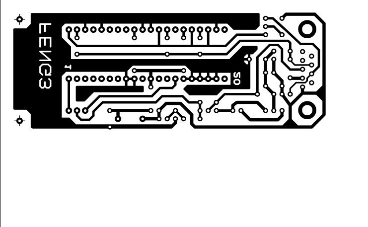

Hi everyone , again , i have successfully made the PCB board using the second PCB revision of the programmer thanks to tunedwolf .
MisterT i didn't try your work , but am sure you were close if not 100% accurate , i appreciate your help .
I hope the programmer will work and finally get into the real world of PIC programming .
Here is picture of the card :
That is not the same PCB you posted originally, but glad you found a copy that you could print correctly.

I will try to explain my procedure in a few lines .
So for the procedure i used the traditional method of toner transfer into the copper,by the way i printed the layout on a magazine paper , it gives a nice transfer once heated , for that i used the clothes iron set on medium , and applied little pressure all around the paper surface until i see that the layout traces have stick on the copper .
Now all you need is let the copper cool down and then put in a bowl of water with some liquid soap in it , let it there for 15 minutes , then peel it off with precaution until only the black traces are on the copper .
Now put it on a small iron III chloride reservoir , and shake it until all the copper surrounding the black traces is gone .
Only bad thing about this is using copper , i hope that i could use another metal instead but this would require using different chemicals for etching , copper traces can easily break when your soldering components on it due to the copper layer thinness .
