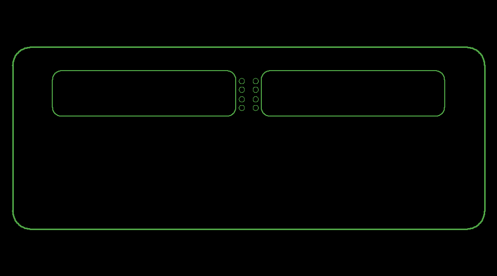

I'm looking at using the Elecrow service. How do you specify a slot or cutout? (Please try to keep the instructions as generic as possible, I will likely need to translate into Protel 99SE)
You need to show slots and cutouts on a Gerber mechanical layer, usually with the extension GML.

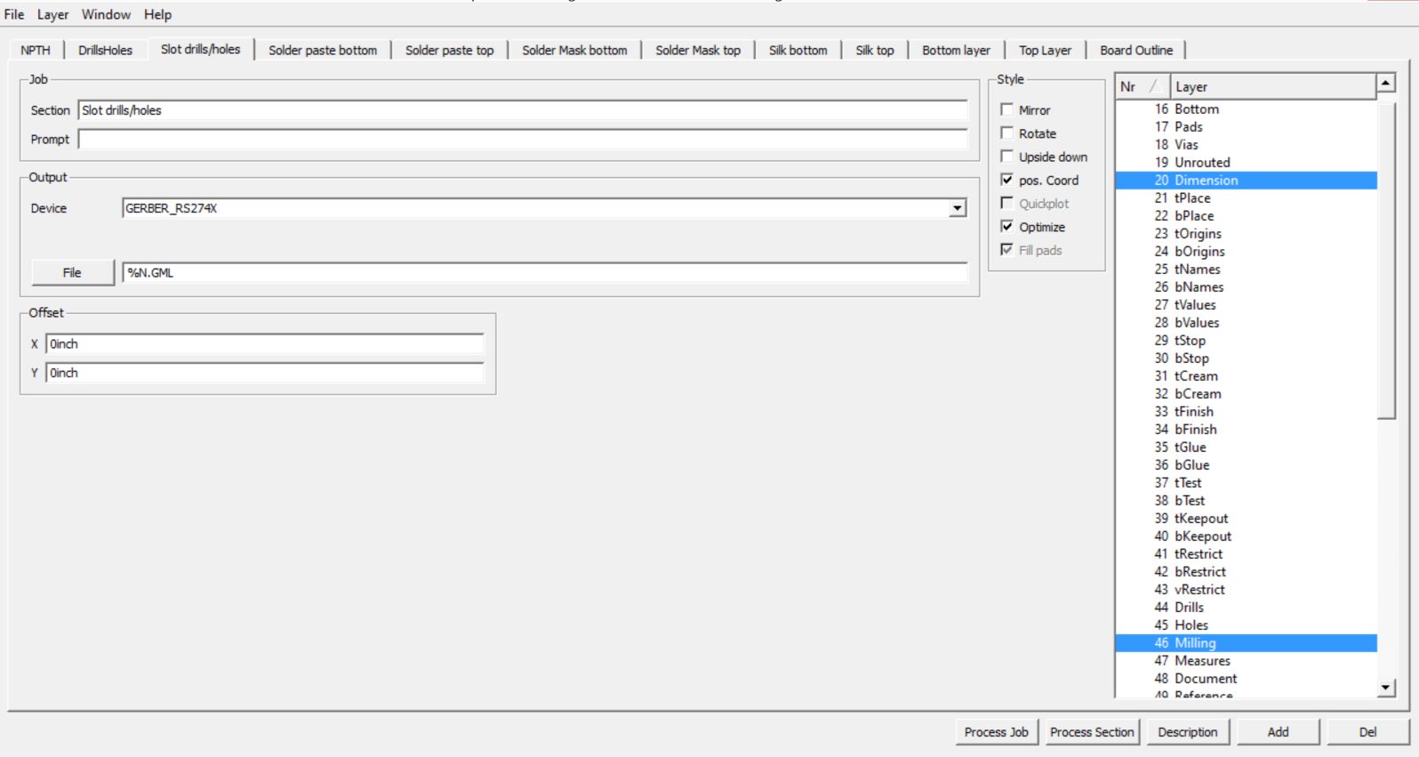

In Eagle, you show the slot/cutout in layer 46, the milling layer. The CAM includes this layer in the GML. The picture below shows the mechanical layer. The outline is the board outline. The two rounded rectangles are cutouts. The outline of 8 non-plated holes are also shown.
The Eagle CAM section is shown below. I don't know how this translates into your software.
I also include a readme file with the Gerbers, explaining there are slots and cutouts.

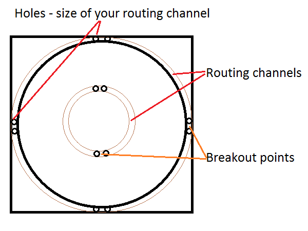

I want to make a circular board (a donut), 2" radius with a 1" radius hole (the resulting board should be just 1" wide). I place two circles on the mechanical layout, (one at 1" radius, one a 2" radius).
Do I end up with a the board I described, or is it narrow by the diameter of the bit because the center hole was cut to the same side (outside) of the line as the outside edge of the board?

What I would do here is create a square board, place a 4mm routing groove around your board with the words "route" to show what to do. For each routed section use 4mm unplated holes at the starts and ends, but keep a gap between them to hold your board in place. See pic attached for what I mean, explain it all on a mech layer, hopefully it makes sense.

No. Whatever shape you want the board to be, draw that as the board outline. Rectangular, rectangular with rounded corners, round, in the pattern of an oakleaf. Just remember, it is routed, so any inside corners will have some radius.
For your round hole, make a circle of the diameter you want it to be. Done.
For your inside cutout, draw a circle in the mechanical layer with the diameter you want the hole to be.
For slots, I draw the perimeter of the slot I want,without any allowance for cutter size and without any drills involved. I have gotten exactly what I wanted when I've done this.
I will post some examples shortly.
No need for the examples. I follow. Draw what I want and be done with it. If I want a donut, then draw the two concentric circles and submit.

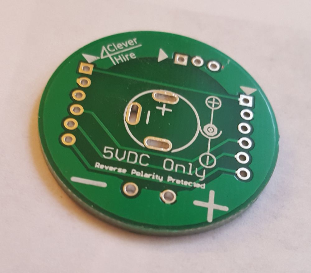

I feel like posting pictures :)

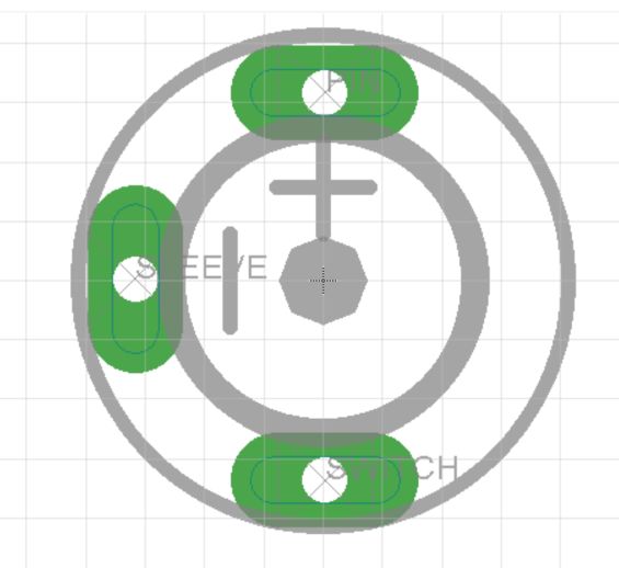

This is the package drawing for a DC power connector. I followed somebody else's lead on this, and put slots within the hole/pad. You can see thin blue lines defining the slot.

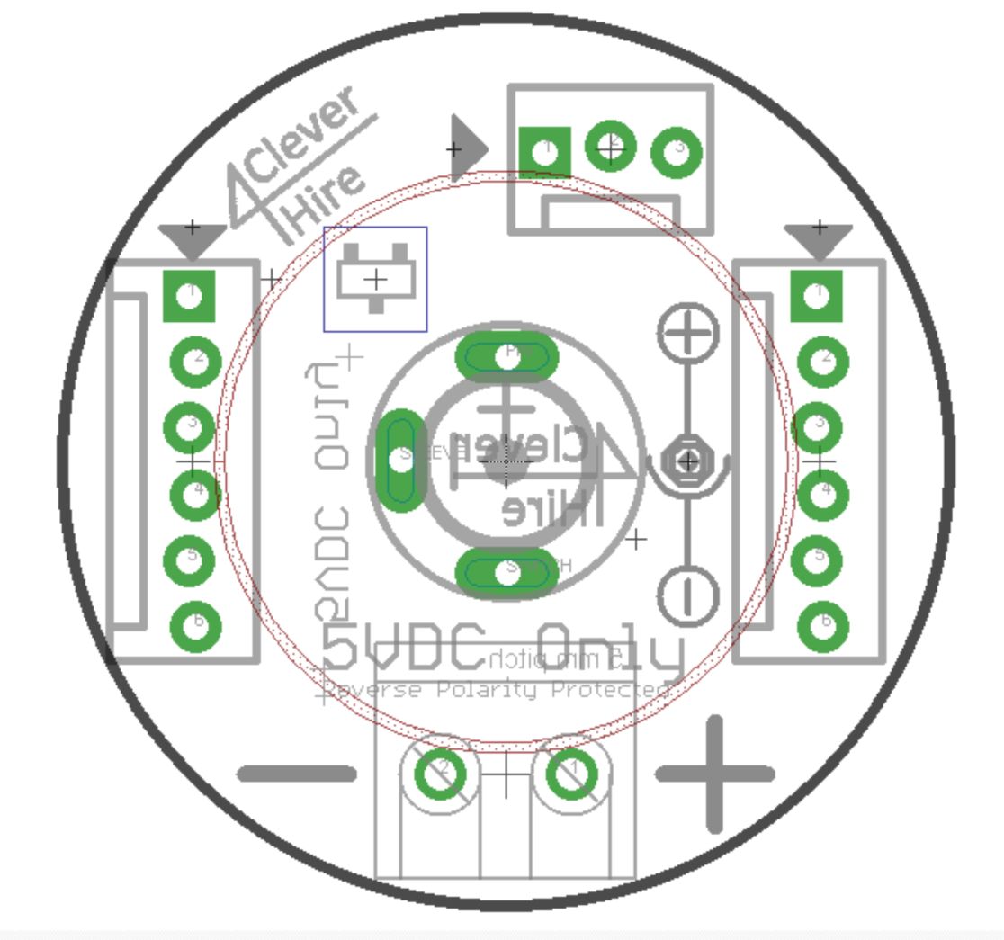

This is the round board made with this package.
And finally, the result. It's difficult to tell, but the slots are plated.

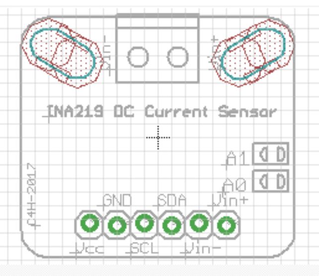

Here's another PCB footprint for mounting INA219 current sense modules. Functionally identical modules come in two sizes, so I used slots to accommodate the mounting screws for either version. The blue lines define the slots and the finished boards using this footprint reflect this exactly. The hashed lines represent copper restrict areas for fills, as I didn't want these slots plated, but this may not actually be necessary - see next example.

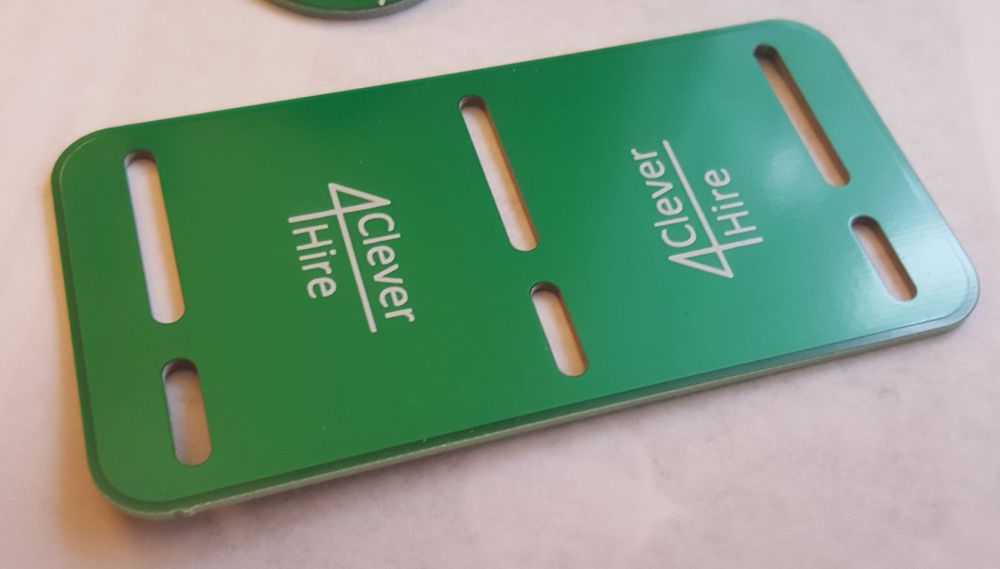

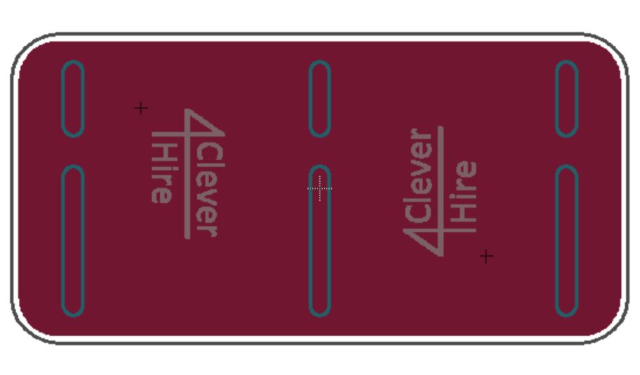

The last example is a spacer board I made. As above, blue lines show the slots. These boards have copper fills but the slots are not plated without any special effort on my part.
The boards do not have plated slots.

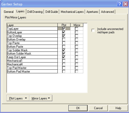

The CAM processor for my NPTH layer has only the dimension layer and hole layer included, without the drills layer. It pops up a message every time asking if it's ok that holes are selected but drills are not but only non-plated holes show up in the output. The top and bottom copper layers have neither drills nor holes included. Give this a try and see what happens.
I just cannot find a way to do this. I do not see any options that allows a gerber file to be generated with circles for the holes.
I can generate the drill drawing (third tab) that has differently shaped same size symbols for the drill locations (uses .Legend to show the drill sizes). I can also generate a drill guide (fourth tab) that has varying + symbols for each hole (does not indicate the specific hole size just where and may be different size).
I have 14 mechanical layers, 16 internal planes, and 30 mid layers I can add, but nothing that is specific for showing only the NPTH holes. If I (have to) do this it looks like it will have to be done manually. (unless someone recalls how to do this in Protel 99SE)
However, I did find a way to include the board outline on each layer without having to draw it on each layer (a setting on the Mech Layers tab #5). :) Now the mounting pads are too close to the keep out line which on top and bottom will turn into copper. :( Looks like I have some squishing to do.
Update: Moving the board outline so it shows up on all layers had a negative side effect. Although it prints on the keep out layer, it isn't on the keep out layer so no design rules to the board edge are enforced. :( Looks like I have to have the board outline on two layers, a mechanical layer and the keep out layer, if I want the auto router to stay in bounds and the board outline to show in all gerber files.
