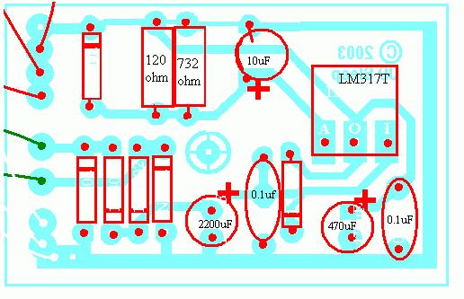

I would like to try some PCB etching for the first time.
I'm planning on using it for this layout
http://www.generalguitargadgets.com/index.php?option=content&task=view&id=77&Itemid=106
A quick question, I printed out the sheet seen here
But it came out in full size, how do I print it in real scale?
And any helpful information on PCB etching would be great.

the image looks to have been produced at 600 DPI so needs to be printed at that pitch. it would have been a lot more precise if he'd just put up a gerber with a pointer to something like pentalogix viewmate for printing.

I think for my board im just going to use one of the plain ones instead of make one...from what i have looked up, its quite a bit of work but it sure does look good in the end.
I could go and buy a made board or make one to the plans but with the different components i got like the bridge rectifier, its not layed out the same. Theirs has the leads at each corner but i ordered a BR with all the leads in a row.

Im looking for a premade board again...i dont really want to go through making one myself for just one project though so im looking for someone else to make the one i posted.
i emailed the guy at the site and he said he would change the layout of that PCB so it printed in the correct size.

well here's the new layout of that power supply...(i had to change the layout a little) (attachment)

I'll give it a try tomorrow and if it does not come out well ill see who here has the time to make one for me...I have those small drill bits for the dremel that I can try putting in the drill press so drilling should not be any problem.
I figure with a layout like this its best to make a board this time.
when I look at a wiring schematic I'm the type that cant lay it out on a board....I just stare at it for minutes lol

That should be an easy one. No 40 pin DIPs. I have also used a Shapie Marker on somethng simple like this. No laser of photo copier required. You draw or trace it on the board (after you clean the copper well). Drop it acid 5-10 minutes, rinse and drill.
