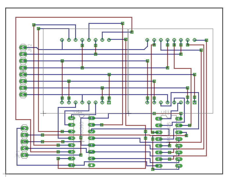

I Have seen both of those before. The only way i can see of doing a simple but time consuming dual layer board is by create a ton of VIAs which SUCK! but heh what can i do? I guess i have to suffer through it heh... here is a picture of a board i have/want to do:

I find via's to be fairly easy, but I use paste and a hot air station. They are certainly a hell of a lot easier than any plating technique I've seen.

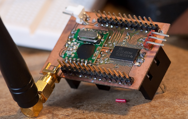

Many components, like the DIP's you can solder either the top or bottom side, so there's no real need to move the trace to the bottom unless you are using a socket. I've also soldered the top side of headers. You can slip the plastic part of the header up and down the pin. Hard to explain, but these headers have all been soldered on the top side.

Maybe you aren't printing the layers properly? For etching, one of the layers you need to print mirrored. For toner transfer you need to print the top layer with the mirror box enabled. The bottom layer is already mirrored, since you are looking down on it.
Also, that it a terrible auto-route.
