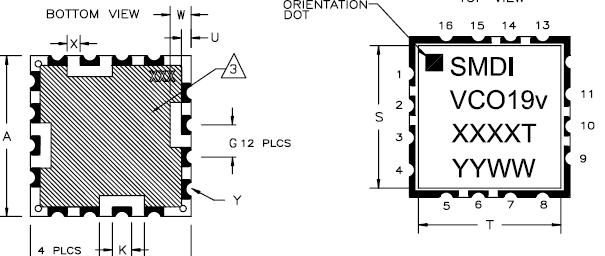

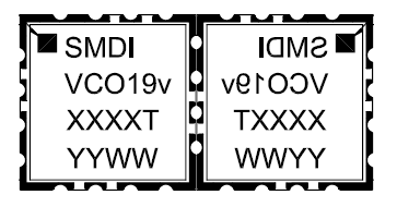

Greetings ETO land. I have a need to build some PCB's (RF Filters), that can be soldered onto another PCB as though it were a component. Much like the VCO part pictured below. So my question is, how does one go about laying out a board like this? What I mean is, I imagine I make the circuit board with the footprint like below, but somehow, there needs to be some breakoff point thus creating little pcb components. So has anyone done something like this and can you provide a little write up how I should proceed. I should mention that the part, has copper going along the side like a plated through hole cut in half, thats the tricky part to me.

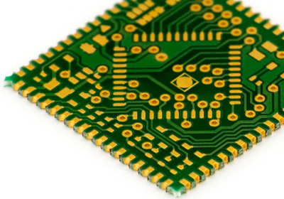

I believe what you require are "Castellated vias" or simply "Castellations".
If you are having the boards made by a PCB fab house, one suggestion on EDAboard was to lay the vias across the board outline and they will be cut in half when the board outline is cut..

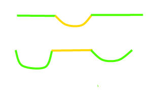

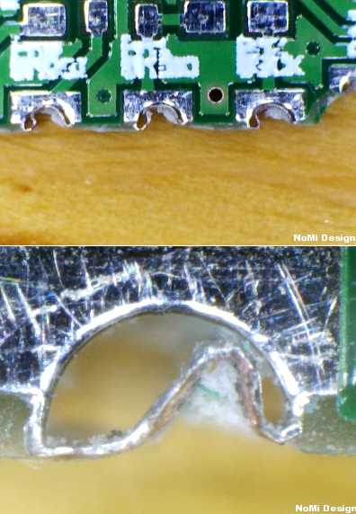

From what I read, the usual method for creating plated half holes is with a router but as shown in image below, damage to the copper walls can occur. The workaround is to change the way the routing is done, but this requires changes to the setup and is slower, so this requirement must be specified and discussed with PCB vendor.
Done properly a nice looking board on board design can be made.
