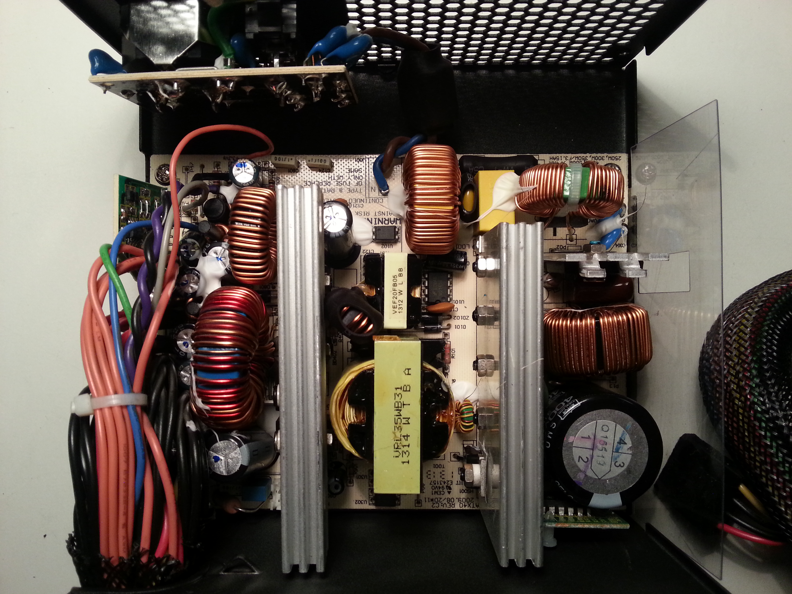

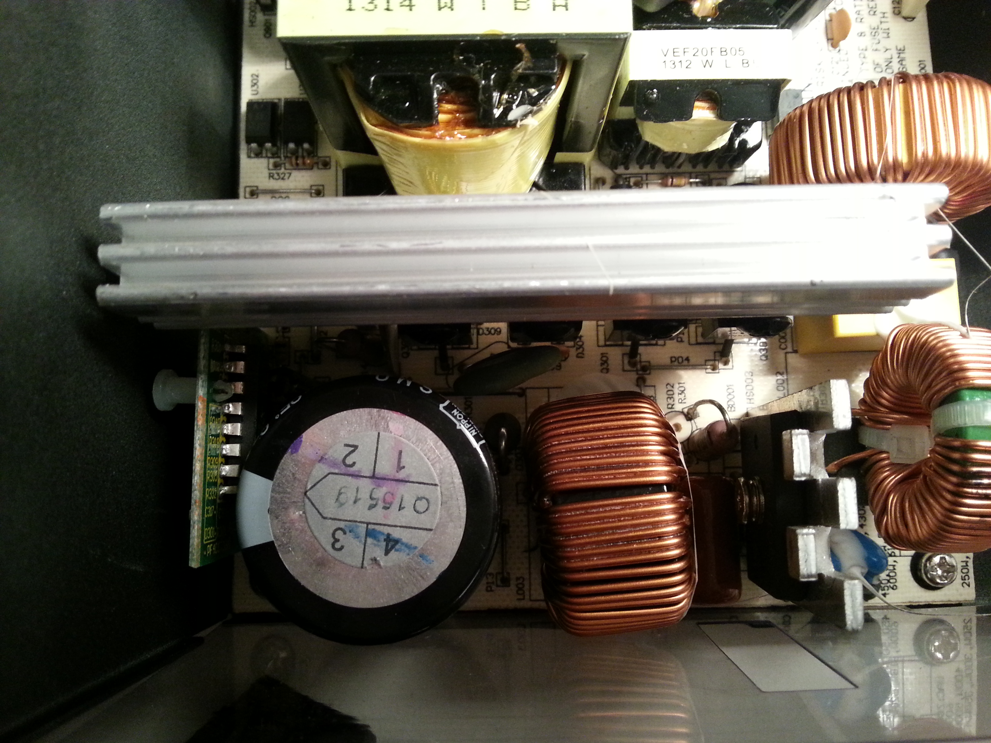

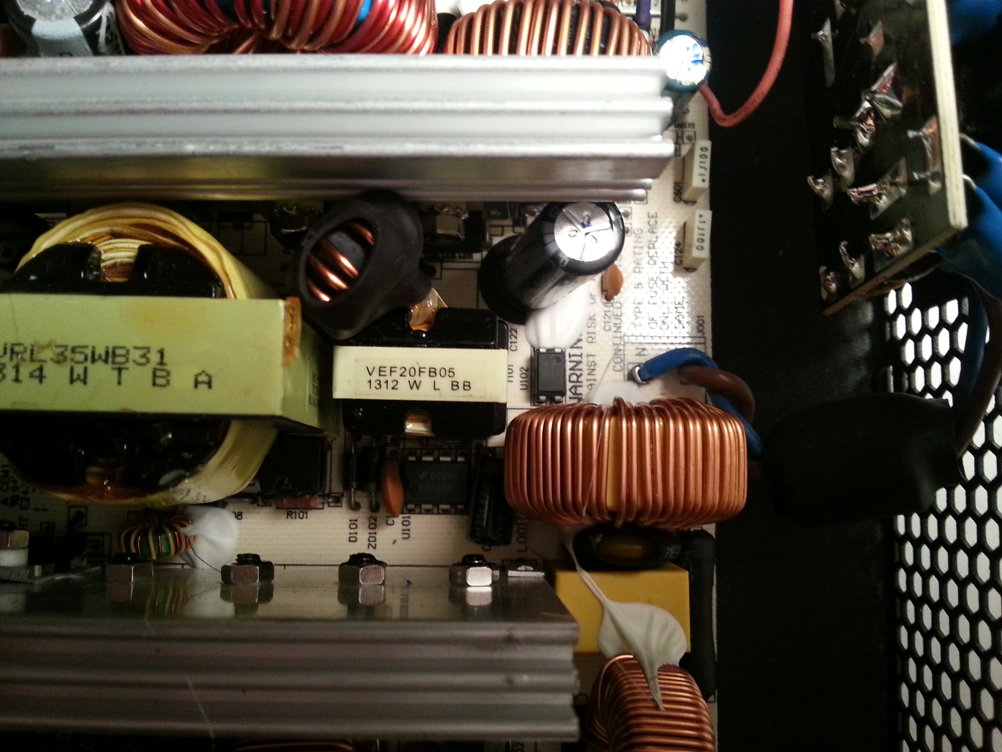

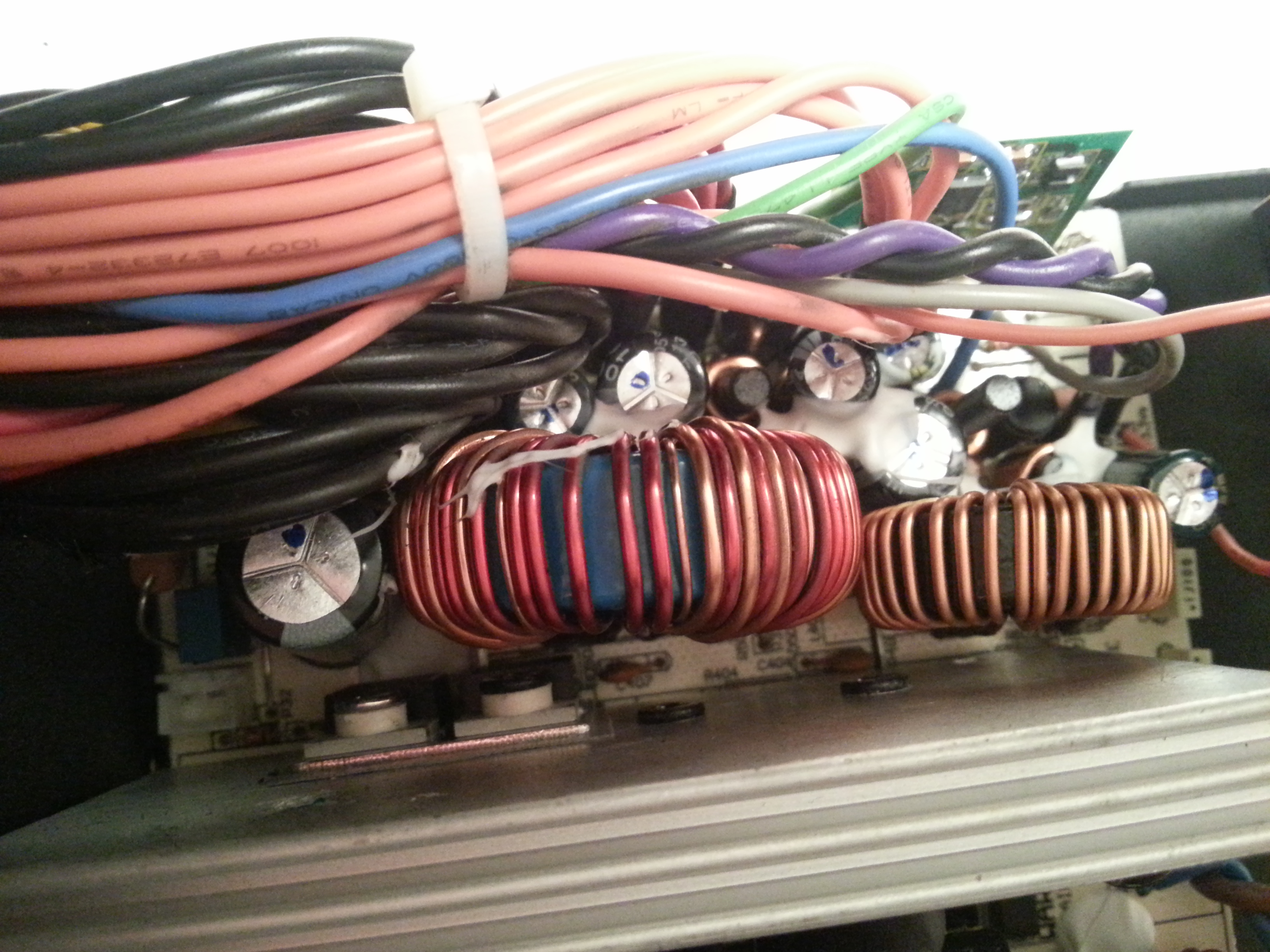

Here are some pictures.
20140622_025414.jpg 20140622_025518.jpg 20140622_025513.jpg 20140622_025500.jpg 20140622_030513.jpg
Looks pretty much like how all of them look. Looks like a ATX form factor SMPS (Switch Mode Power Supply). So what is the plan now? Nice pictures though and did you read or use the link I provided that explains the operation of these things? :)
Ron
Ron
I will desolder the capacitors and test them.
If that doesn't come up with anything I will start to learn how the PSU works and what values I should expect to see where, and start poking around with an oscilloscope.
I looked at the link, thanks!

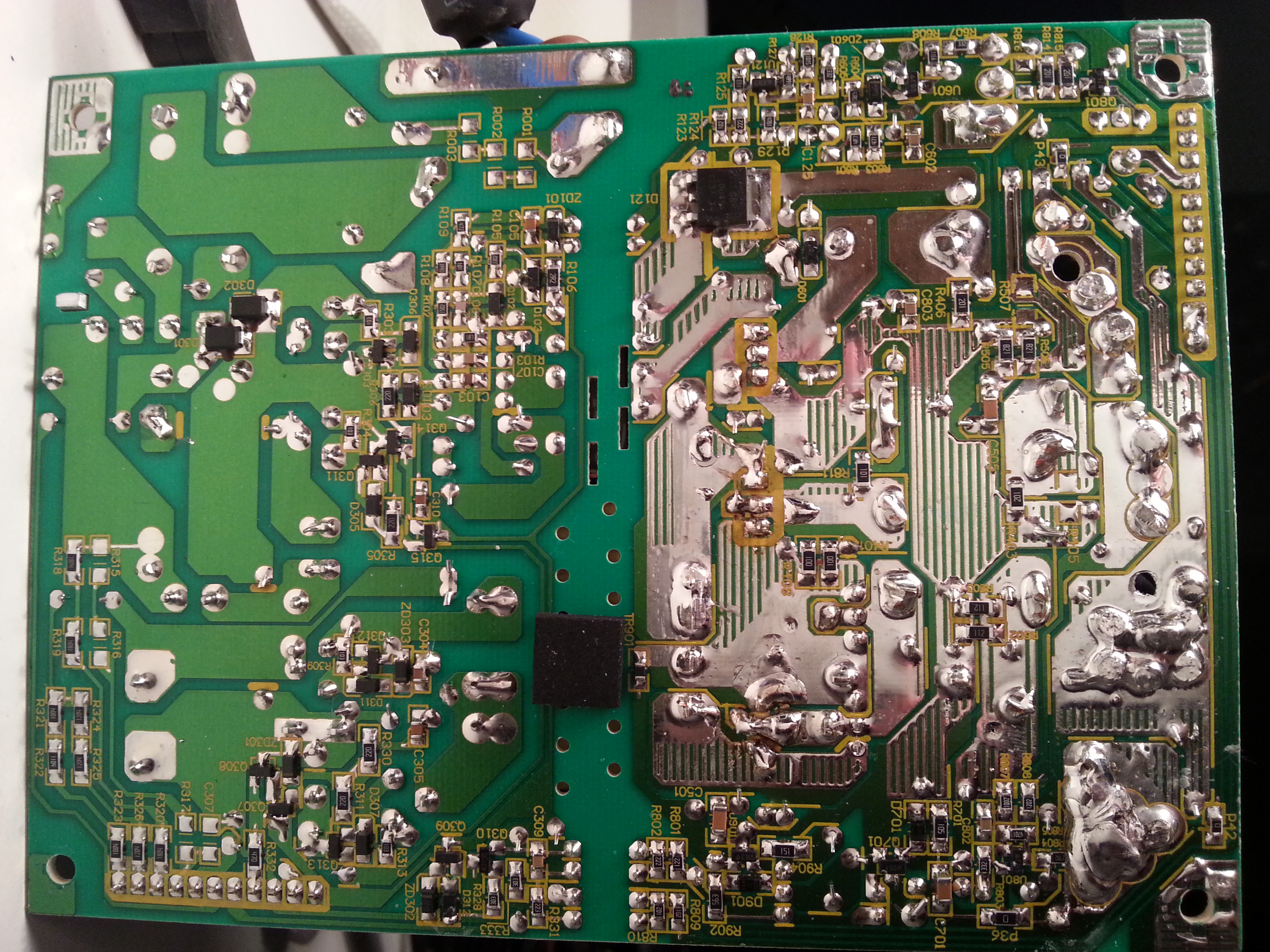

Some of the solder joints look awfully messy in the image of the bottom of the board. Did something happen to it, or is the photo deceiving?
I'm not sure which solder joints you're referring to. Do you mean in the lower bottom right corner in the picture? This is where the bundle of yellow wires are soldered in. It does look like a mess, but I'm not sure if it matters. Did you imply that there is some kind of short there?
So far I've only managed to desolder a single capacitor. It is very hard to work with this PCB, the capacitors are glued down, very tightly packed and hard to get a hold of. At the same time this huge bundle of wires is also annoying to have to deal with.
