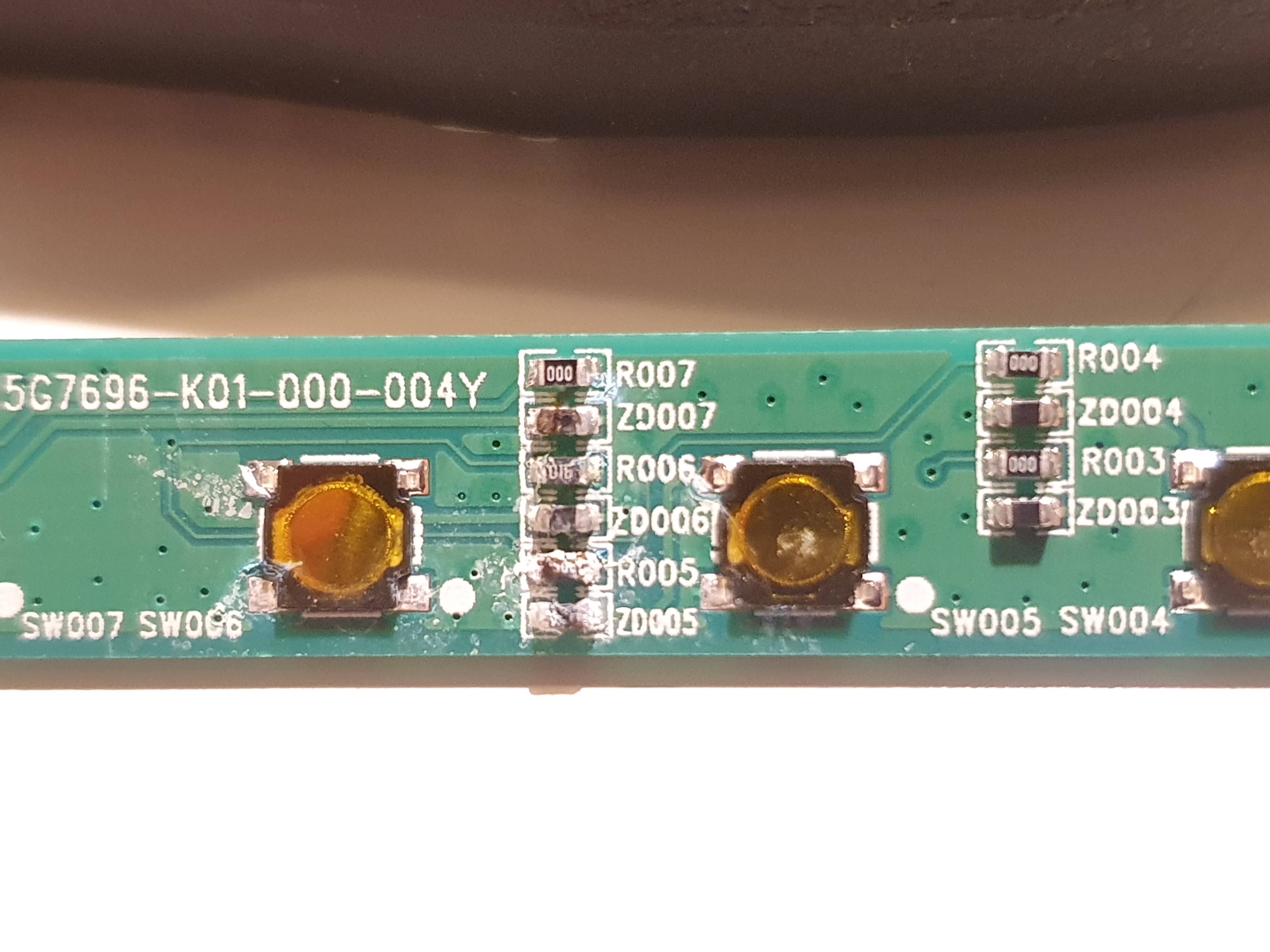

I managed to spill water on my screen yesterday, and today it doesn't turn on. I did a bit of thinking and figured that the only thing that could've possibly been damaged was the circuit board for the powerbutton and the other setting-related buttons, on the very bottom of the screen. I succesfully debezeled the monitor and found alot of corrosion on what I think are Resistors and Zener diodes (judging by the letters on the board). I know very little about electronics so I have no idea if these components are completely destroyed or not.
Is there any hope of cleaning it up (and if yes how do I best clean it?), or should I start a deepdive into finding some replacement part?

If you are able to remove the PCB the best cleaning will be ultrasonic, next would use IPA (isopropyl alcohol) with a medium toothbrush. The objective is to remove the conductive salts or minerals that are shorting the different components causing a confusion in the processor. Corrosion within the small switches is the most difficult part.
If it turns out that the board is dead, would it somehow be possible to create a makeshift solution? Literally all I need is to turn on the screen, I never use any of the other buttons and settings. Would it be theoretically possible to create my simple own on/off switch, bypassing the dead board? I've had no luck finding a replacement
Not likely. Customer access controls usually operate on a voltage divider system where each function request signals the main processor chip with a predetermined voltage telling the processor to activate that request. Don't give up on cleaning. Lookup resistance ladder controls on google.

There's little 'dangerous' stuff in an LCD monitor - and none of it on the front buttons.
Stiff brush, alcohol, GOOD clean.
There's very few buttons anyway - so it would be trivial to create new ones for the ones you need - you just need to sort out the resistor values.

or zener diodes - ZD?
I am not a manufacter... I can only guess why there are zener diodes.
If you're going to guess, then make it an educated guess - not just something completely random.
Sorry but it was not random. Since there is no schematic you can only guess. There was not manufacter mentioned, it could be some china no brand monitor with odd quality. ;-).

I think it will be better to modify it or create a new one. Measure voltage on connector to logic board, take 10k res and place it on vcc and other pins. If mcu switch at 0V logic (connect res between gnd and other pins) than you will need probably lower resistor value (470R would be safe for 12v if you connect mistakely 12v to gnd) . Becouse it will act as resistor divider.

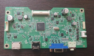

I managed to find this:
(I hope links work).
I have a VP278QG, and the items listed is for a VP278. I can see some differences on the motherboard (mine doesn't have VGA for example). But the important part, the powerbutton board, looks identical.
It should, on a theoretical level (and assuming it's functional), work for mine, right?
I f you have no other options then you might try removing the unused Switches to rule out those being shorted internally. A cheap multi-meter and soldering iron would help . Also the board numbers shown in link and your original photo appear the same
