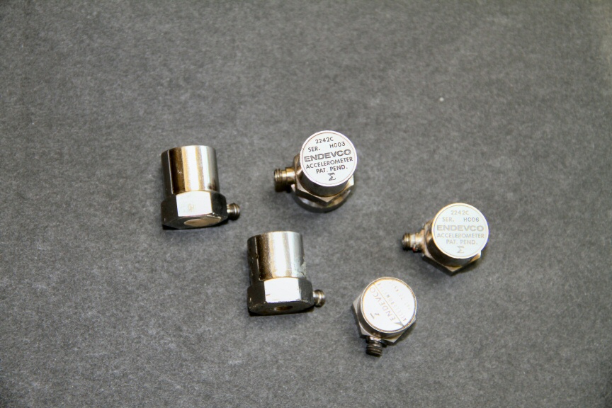

Oh OK, I got it. You could use a circuit as Colin proposed but I would do similar with some changes.
Years ago I was involved in a project to measure the time from when current in a coil decayed to a point (start a timer) to when the solenoid actually released (stop timer). To measure the stop we used an accelerometer similar to those pictured. I wasn't concerned with measuring the g force but only concerned with the "thump" sound made when the solenoid actually released.
I took the accelerometer output and ran it into an op amp for amplification. Then ran the signal into a comparator. The advantage was that I could adjust the comparators reference voltage so it would toggle at a given point of amplitude from the accelerometer. That in turn drove a 7474 D flip flop which would latch. The transition from High to Low on the FF would stop my timer.
Something al0ong those lines would likely work for you as a trigger. I don't have the circuit here at home but I could likely come up with something like it. The trick is setting at what level it triggers and thus I used a comparator to drive the flip flop.
Ron
