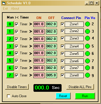

Using Windows XP. Needing a real simply (for some) Batch Script that I can run using Windows Task Scheduler. Using the LPT-1 Parallel port I need to Turn ON and OFF one
Output Pin on the port. I'll be using Port Address 0378 and need to send a DATA 1 for about 1 second , DATA 0 to turn off , and then end script until next useage. I have tried several Parallel Port controller programs, but I have to input or press START and can not automate. Tried writing something in VB and Real Basic, but no luck as of yet.

The Timer Program listed in the above Blog Link is a great little program and works. However, I am still in need of a simple script that I can run via Batch.. I will use it with the JIT Scheduler program which will run the script once per week , every week, at random times. It will be used to trigger our EAS (Emergency Alert System) box to activate our Required Weekly Test. I am not a programmer, but think a few lines of programming will allow me to Turn Pin #2 ON for a second, and then back OFF when the script is ran.. The next week, same thing.

Eric - thanks for taking the time to answer my questions. Unfortunely I am very new with VB , so just trying to figure things out. Yes the ParaTimer2 program works as written. It allows 3 seperate times in a 24 hr. time period. I need a scheduler that will allow me to schedule 6 months or a year in advance as to when this pin is triggered. The JIT Scheduler will do this, allowing me to run a script (.bat or compiled .exe file) any day of the week and month. So a simple Batch file that will turn one of the Output Pins ON and then OFF is what I'm after.. Nothing fancy..

This Schedule1.exe will do what you are asking.
When called the exe will control the port pins ON for the entered period [ I have kept all 8 pins available for use]
Use Timer7 pin OFF time to terminate/close the program automatically.
If you uncheck the Auto Close box the program will stay visible for set up and test.
