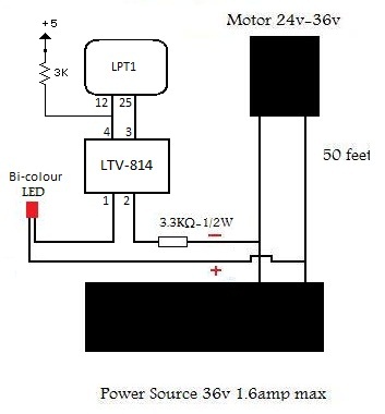

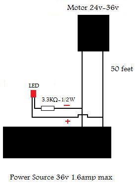

I have a motor that moves clockwise and counterclockwise. I would like to know when the motor is on or off. The direction of movement is not important. Visual indication and also feedback to the parallel port. See image.

Ah. I see now why you chose a bi-colour LED.
An AC opto coupler would be the solution for you. The AC opto couplers have two back to back LEDs just like your bi-colour LED does. The 859-LTV-814 from mouser should work in this application. You could connect it like this:

Yes, it'll work perfectly. It will also work no matter which polarity is applied to the LED input. I chose it for this feature because of your reversing DC motor.

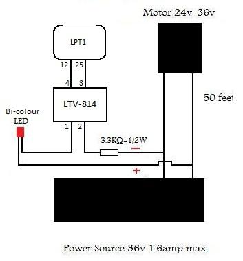

Pin 12 on my parallel port is high. If I connect pin 12 to ground then it goes low. Do I need the +5v and 3k resistor?
Sounds like you can get away without it. If the voltage between pins 12 & 25 is more than 2.4 V, then you can eliminate the +5v and 3k pullup resistor. You still need the 3.3K on the motor side to limit LED current.
Pin 12 goes low when the motor is on but it will randomly flucate between high and low. This problem seems to occur when the voltage on pins 1 and 2 is below 1.18v. Would I be correct in assuming that I need to use a resistor that has less resistance than the current 3.3K 1/2w in use.
What is the voltage across the motor at this point?
How is the motor controlled? ie: Is it controlled via a PWM motor speed controller or is it being fed straight DC?
You could reduce the resistor value to increase the LED current in the opto if the motor is running on straight DC. I wouldn't go beyond 30ma LED current as the max for the LTV-814 is 50ma.
The motor is being fed straight DC.
Motor voltage: 30v(starting)...43v(before motor stops). Problem occurs when the voltage is less than 37v.
Then, yes, reducing the resistor value will work. You'll have to up the wattage rating of the resistor or just add another one in parallel.
