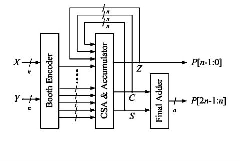

The below diagram is the parallel MAC structure. In parallel MAC both partial product addition and accumulation take place at same time.

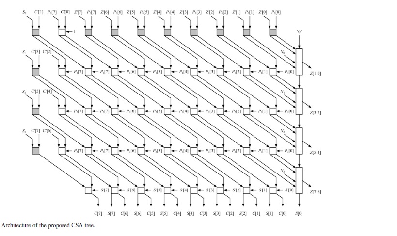

The partial product summation + accumulation unit of above parallel mac is given below.https://i.imgur.com/Jd8WIyD.jpg (link to the image).
My problem : When I give input to multiplier as 00000101(5) and 00001000(8) what will be the values produced, that can be used as input of partial product generation + accumulation stage. What will be the values of S0,S1,S2,S3 And N0,N1,N2,N3 in the second image? The complete document is shared below.

Please share your ideas.I need to continue my project based on your replies.
