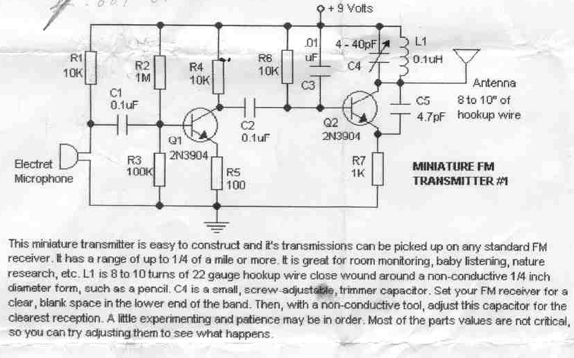

Hello, I got me a couple questions about parabolic mics. First off, what kind of amplifier is used? One like the one in the transmitter pic here? With this amplifier, I can hear myself wisper from across the room. Is it possible to build a parabolic mic w/ out IC's? cuz i would kind of like to try and design my own amplifier n stuff, and am not good w/ IC's. I posted a question about parabolic mics before, and someone said they would give me their email adress . . . I think it was chemelec? They said that they had built some in the past. Thankee :eek:

Hi Zach,
Your transmitter already has an electret microphone amplifier, so why do you need another one for a parabolic dish? Just connect the electret microphone to the transmitter with some shielded cable and mount the mic at the focal-point of the dish.
Your transmitter will probably work much better, especially when the battery is low, by adding a 0.01uF capacitor and a 100uF capacitor, both connected from +9V to ground.
The mic amplifier will have more gain so that the mic is even more sensitive, by adding a 100uF capacitor across R5.
Thx!! So howcome wen i search for parabolic mic circuits on the net, i always get fancy ic circuits? What is the purpose of the 100 n .01 uf caps? Thanx

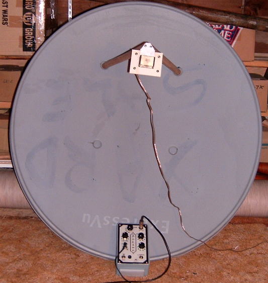

Here is a Closeup of that Preamp.

The Amplifier and the use of Headphones helps a lot. It Needs to be Low Noise. If all you want to do is Talk across a Gym, than you don't need it.
An Adjustable Bandpass Filter or a Low Pass Filter are VERY Useful to Eliminate Unwanted stuff, like WIND NOISE and Cars passing by.
Filters can also "Tune IN" if for example you want to listen to a Bird. (Set it for Higher Frequency Tones Only)
I also use a 6 foot Satellite dish, But Its a bit big to move around easily.
Also Very Obvious as to what your doing.
I have the PCB layout for the amplifer/Filter I designed above and I could also take a picture of the parts layout of it. But I never actually drew the entire schematic when I made it.
Gary
