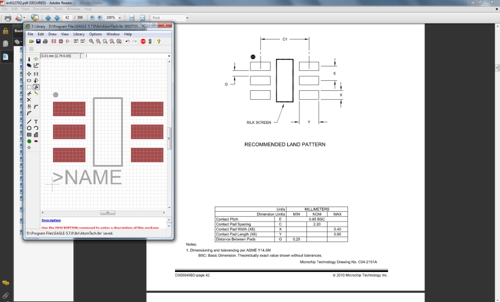

Take a look... nice info:

It would be great, but package standards seem to only loosely be followed by IC makers. I've run into several TO220 packages that have all been slightly different and needed their own footprints made for boards. If only they would fall in line...
yeah thats why i mentioned MICROCHIP heh... most DIP and SOT and stuff are the same tho. Compare a few and im sure there is a standard... Some choose not to follow it and should indeed tell the consumer/user of the IC about the dimensions... anyone one should always check to make sure there the same before using it... I rather have em made then check the datasheet since most are compatible.

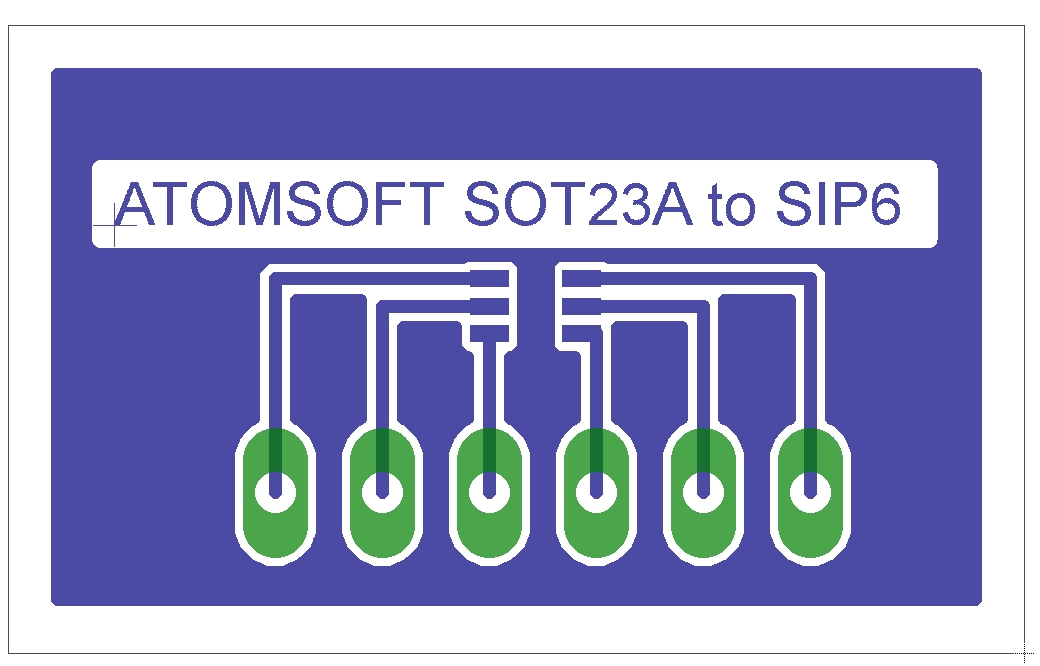

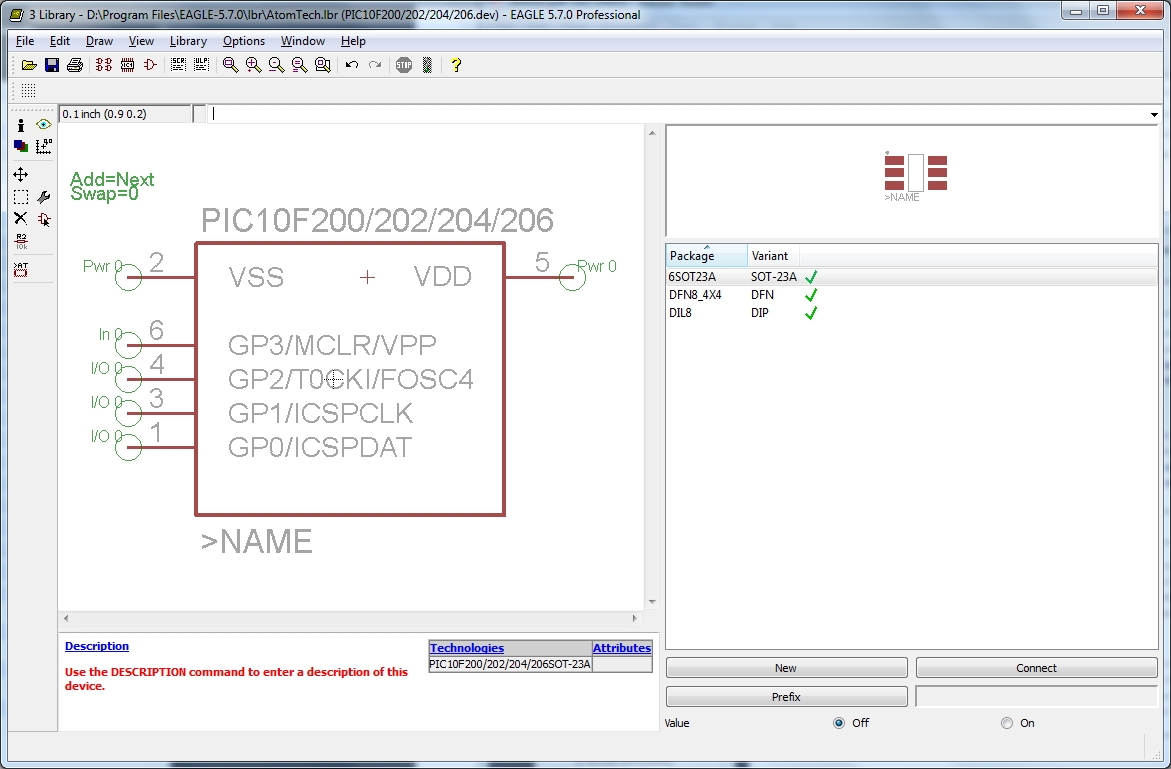

Here is another image... I might make a Eagle CAD tutorial on making Parts... im sure most know but there are new people all the time :)

Knock those 90 degree bends off to two 45's.
