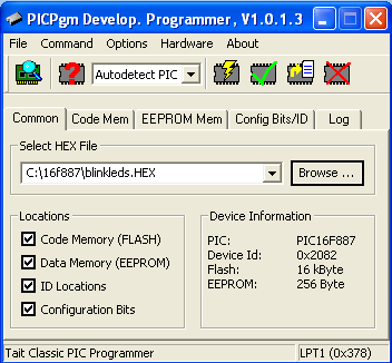

ChemE, as promised I've done some testing with my parallel programmer and WinPIC800. The PIC16F887 is not supported with that hardware.
I've succesfully programmed the 887 with the PICPGM programmer - I was right on this ;) Take a look at the attached image, the PIC has been autodected*. You might have to re-configure the software for your hardware even if it says that the programmer has been autodected (because there are a few different variants of the Tait programmer, mine has a 7406 + pnp transistors).
* the program memory should be 8k.

Thank you so much for your help eng1! It is great to see that the p16pro40 is still alive and kicking. AWESOME!
