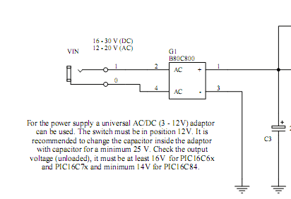

Don't read the description of how it works, read what it says to feed it! - notice above it says 13V for Vpp - so you need about 18V DC in order to get a regulated 13V .

hi whiz,
The pdf clearly states the input voltage requirement, see attached clip from the dwg.
I am working my way thru the artwork, but it seems to have additional components to whats in the original design.?
Are these overloading the 78L05 ref.?
As suggested by 'kchriste' remove the 74L and PIC from the pcb.
Connect the pcb to a 16Vdc psu and measure the current into the pcb.

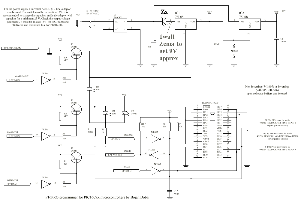

Perhaps we can't expect even70mA from 78L05 with 16 or 18V DC as input.
the O.P may have to measure the load current at the first instance the unit is powered in before it shuts down.
perhaps it is better to add a series resistor (or even a series zenor of say approx 9V) for lower input to 78L05.a schematic with proposed mod is attached.

The P16PRO is a very old tried and tested design, it works flawlessly - no need for adding extra bits. If it's not working, and it's getting hot - something is badly wrong. It's a very simple circuit, easy to understand, and easy to fault find. The suggestions of removing the PIC and buffer chip are good ones - I'm presuming he's using the correct buffer chip, and not substituted a non-open collector one?.

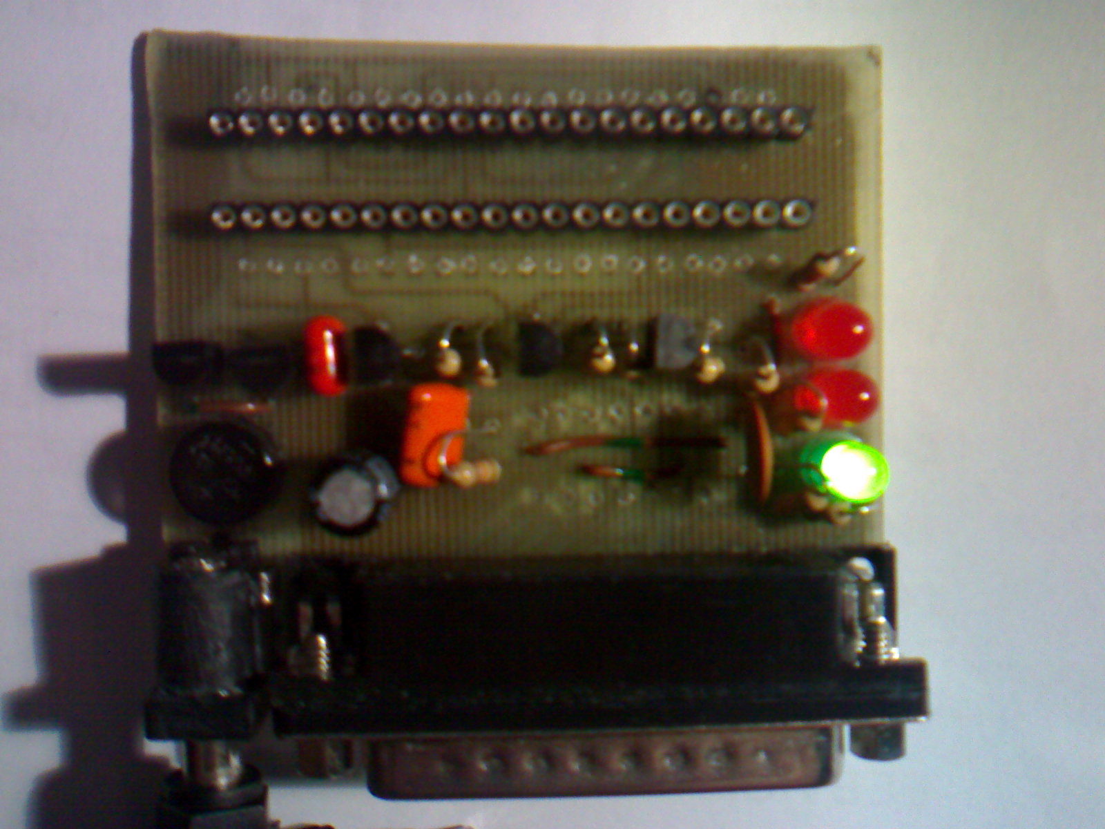

without the IC and at 12VDC (as kchriste suggested...) the 78L05 gets less hot and as you can see in the following picture only the green led is turned on.
the IC says DM7405W it's a hex inverter with open collector Outputs

Ooooohhh... The W version may have a different pin out from the regular 74xx series chip with the power supply pins on 4 & 11 instead of the regular 14 & 7. I have an old data book here that mentions this for the 5405W which is the military spec equivalent of the 7405W. They don't mention the W version for the 7405; just the J version.
My original thoughts:
The 7405 will draw apx 18-33ma from the supply where as the 74LS05, which is spec'd in the schematic, will typically draw 3.6-6.6ma. So that may be where some of the extra heating comes from but, if the 78L05 is still getting hot with the PIC and 7405 removed, there is something miswired.
The main issue I have with using the 7405 or 74LS05, is that the open collector outputs are only spec'd to operate up to 7V where as they are being asked to switch 13V. A 74LS06 would be the better choice as it can handle up to 30V.
