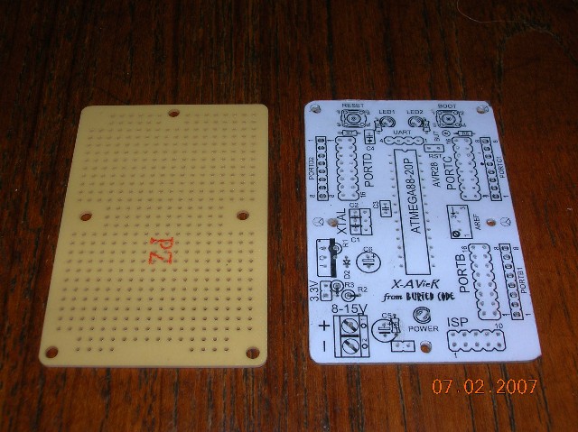

Update!
Just to finish off this topic, I finally got around to some tests. I used the silkscreen layer on Eagle and just glued it to a prototype board I got from ebay (basically tripad). I think it turned out ok after it was sealed to protect it.
Sorry for the bad picture, don't have a desk tripod or anything just a camera I 'borrowed' form a friend. This was just a test board, a simple AVR dev board that I spent literally 10 minutes designing, I just need something with a programming header and I/O ports to get me started on these. I even gave it a cheesy name, the 'X-AVieR'. :D (Copyrighted!)
I have a much larger design for a 'project board' (LCD's switches, pots etc..) on the way. I'll deffinately use this process to tidy it up, its so simple after all.
Thanks for the advice people.

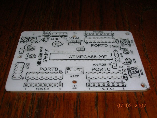

Nice! What did you use to adhere the paper to the board? Are you concerned about the adhesive going through the holes and affecting the solder joints? I may have to give this a try!
I used 3M's photo mount. Its expensive, sticky, and gets you proper high if you don't have lots of windows open (colours get a whole lot prettier :eek:). As for the holes, the glue/paper does go through the hole, but because the board is full of holes, theres an easy reference to 'punch through' with a needle. Its almost like drilling, but you only have to go through paper/lacquer (or clear vinyl, which seemed the best). I did another board with random parts on it to test if soldering melted/burned anything, and it seems fine to me....even when I held to iron on so long the pads came off. that photo is a bit weird, the holes look messy, but they're covered up by the components anyway. heres another pic comparing the before/after.
One could print in colour, any soldermask/silkscreen colour they wanted. Its still just cheap stripboard/veroboard/tripad but adds a bit more aof a professional touch :D
Blueteeth
