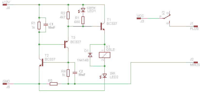

Hi all.
What do you think about this simply overcurrent protection circuit (pros and cons) ?
Or some improvement tips.
Also I think that in this circuit we don't need D1 diode.
You definitely do need D1 as it will prevent T1 and LED2 from overvoltage when the relay turns off.
Any way, the biggest problem with this circuit is that there needs to be at least 0.7V drop across R5 for the protection to kick in which may adversely affect the circuit that is powered from it.
If I understand how relay coil behave during turns off time. The inductor " kick" voltage cannot be greater than -Vcc.
Because relay coil is connect to a BJT emitter. So we don't have a open circuit situation here.
How did you come to that conclusion? The shorter the turn off time, the higher the kickback voltage.
Assuming the transistor turns off instantly, then the voltage on the coil will rise either to infinity or untill something else gives way. It could be the inter-winding isolation of the coil, but much more likely it will be the breakdown voltage of the transistor plus reverse breakdown voltage of the diode, so about 55V. Then whatever current was flowing through the relay will flow through the diode and the transistor, but the transistor will have 50V drop across it and the diode will have about 5V across it, which could destroy them both.
After T2 and T3 "SCR" is trigger, the voltage at T1 base drops to almost 0V. So the relay coil tries to keep the current to flow in the same direction as before.
The inductor " kick" voltage at T1 emitter goes to negative potential. And when this voltage reach -0.7V the BJT goes into conduction mode again. T1 will be ON until relay coil "discharge" their all energy.
How much current flows through the relay coil? Is LED2 capable of withstanding that much current?
Sure looks like LED2 is vulnerable to getting zapped by the inductive kick without D1.
Will the relay pull-in reliably with only ~9V across it?
The relay coil resistance is 390Ω
Can you explain how is is passable. Can you point where I make a error in analysis show in post 6?
Yes
There is a huge current spike through T1 when it turns on.
Inductive load and a current spike ?
What resets it?
Switch-off power supply.

Can you show a better solution for 10A surge current (car battery charger).
Any time you connect a DC power supply (which has an open-circuit voltage more than ~13V) to a partially discharged car battery, the initial charging current is limited only by the power supply; the battery is happy to accept a charging current in excess of 50A which in all likelyhood will overheat the supply.
Putting your relay circuit between the supply and the battery means that it will always trip when the supply is first turned on. You cannot ever charge a battery with it...
What you need instead is a power supply which is current-limited as well as being voltage regulated. The inital current limit is to protect the supply from the battery; the voltage regulation is to protect the battery from being overcharged by the supply after it has reached full charge state.
