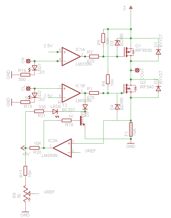

I made a motor controller (double full H.bridge). When I power it over an amp meter (DMM) the mosfets runs cool up to 6.5 A, but when I connect it directly to the power supply it functions well but the mosfets heats much (less than 10 sec) even at 0.5-1 A to the point that it burns the finger tips.
Then what's wrong about this ? What is happening inside the amp meter that doesn't happen when connected directly ?
The power supply is a 12V AC transformer, Diode bridge, 0.1uF and 2 x 2200 uF capacitors. part of the h-bridge is this:
Thanks.

I sent only part of the schematic because the same part repeats and I touogh the problem lays in the mosfet switching logic or mosfet protection. The DMM isn't part of the schematic i connected it for debug purposes then I noticed that once being monitored by the DMM it doesn't heat anymore.

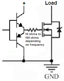

The resistors on the gates of the Mosfets have high values so they charge and discharge the high gate capacitance of the Mosfets slowly. Then the Mosfets ramp slowly on and off. They heat a lot while ramping.
Use complementary emitter-follower transistors to drive the gates through 22 ohm resistors.

Or when properly switched in and out of saturation with fast rise and fall times to minimize the time they spend in the linear region, as well as providing adequate deadtime to minimize shoot through currents which is the prime reason for heating of mosfet halfbridges in switching applications.
