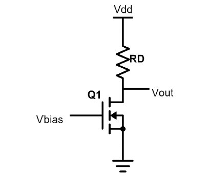

In the circuit below if Vout=2v assuming Vdd is 2.5v, in this case can anyone tell me what is the output swing? (Vbias is 2v if needed)
Your circuit with an N-channel Mosfet and a drain resistor and having a 2.5V supply should have its Vout at half the supply voltage (1.25VDC) for maximum output swing of 2.5V peak-to-peak if there is no load.
Since you want the Vout to be 2V then the maximum symmetrical output swing will be only 1Vp-p. Vbias depends on the Mosfet spec's.
What do u mean by this: "Your circuit with an N-channel Mosfet and a drain resistor and having a 2.5V supply should have its Vout at half the supply voltage (1.25VDC) for maximum output swing of 2.5V peak-to-peak if there is no load". why would it be at the half of the supply voltage? Vdd is 2.5 v. why do you say "peak to peak" for that?

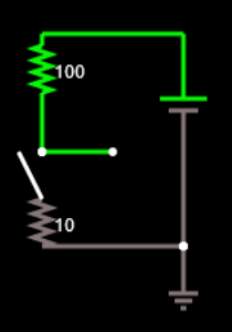

If you can figure out the swing on this circuit. when the switch opens and closes . This may be similar to the FET switch. Consider Vbat=10V for example.
There is no output swing since you say that Vout= 2V.
Please provide more details. Is the average Vout= 2V during an output swing? Or is the quiescent Vout= 2V? Do you want Vout to be the maximum symmetrical output?
