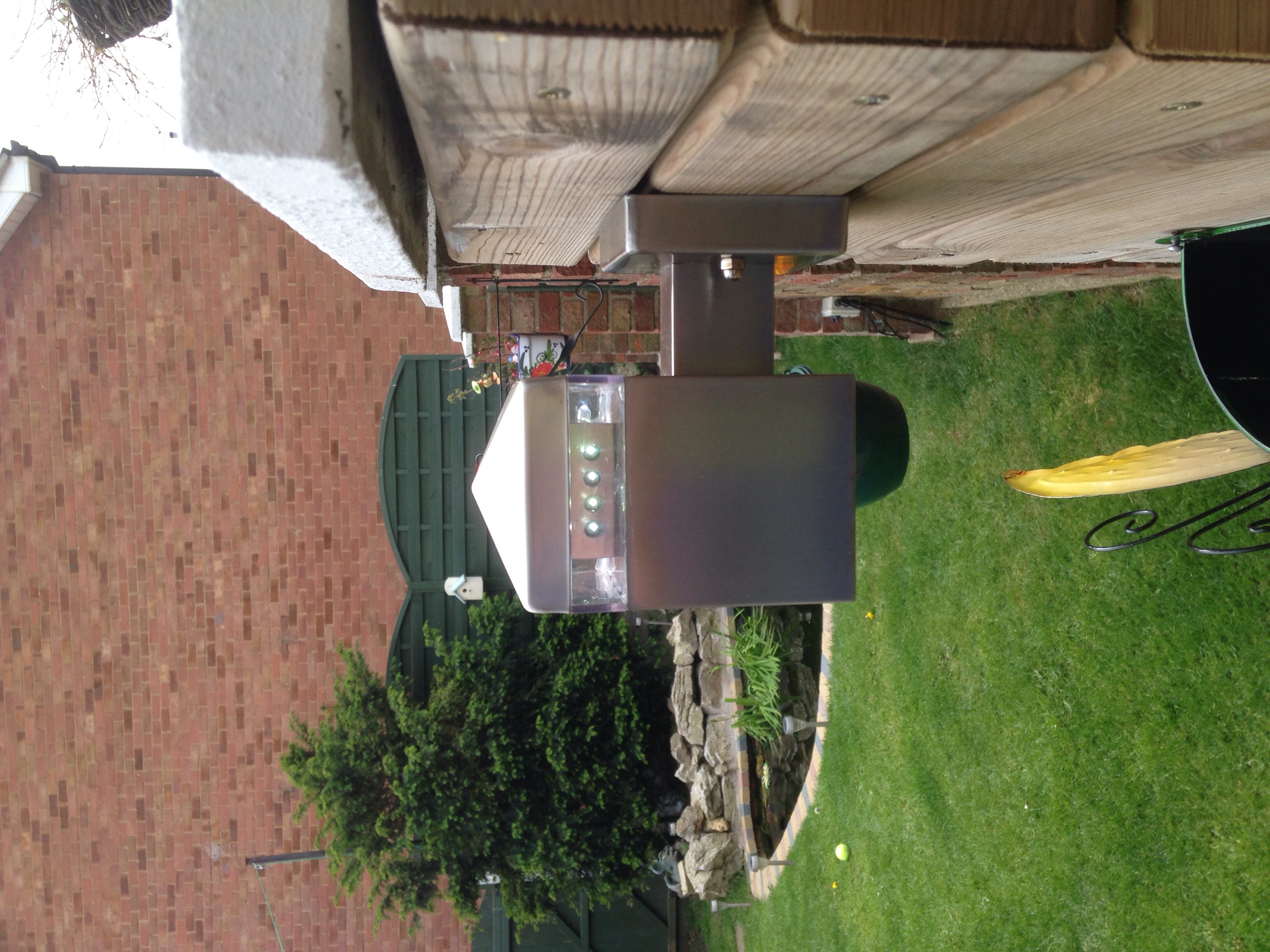

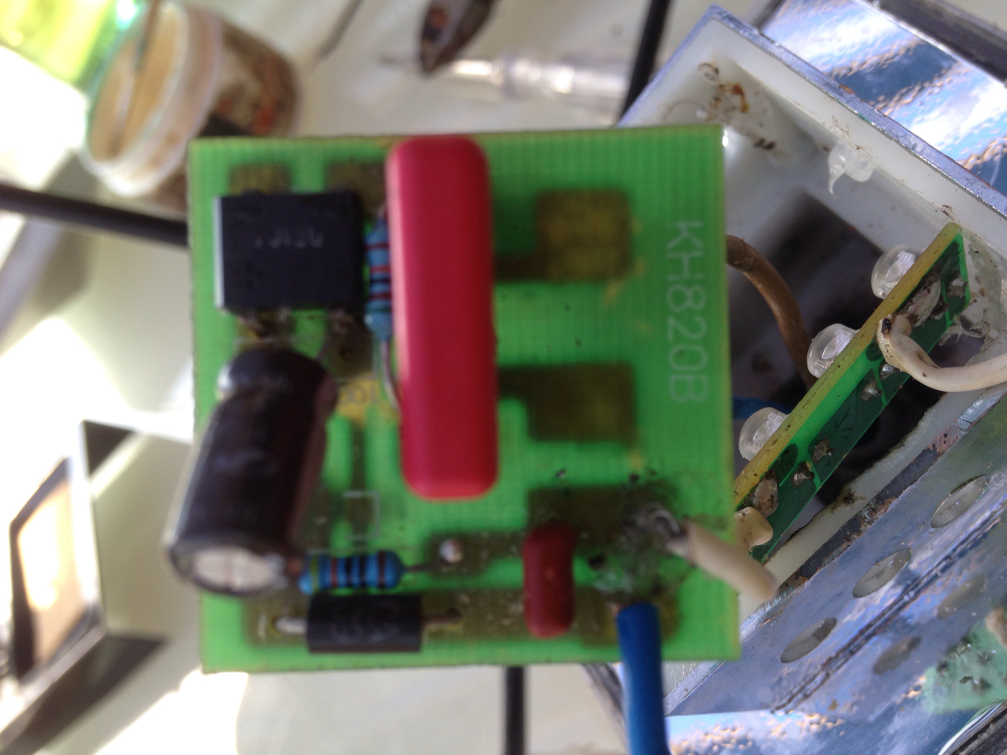

Managed to repair an outdoor Luxform LED light. But this was short lived, as it looks as if the back of the circuit board which measures only about an inch square. Has shorted itself out on a part of the light structure itself, blast!!!!!
How difficult would it be for a novice like myself to construct a new circuit board? This wall light isn't made anymore. So, I know have one light that works on one wall. And one that doesn't on the other!

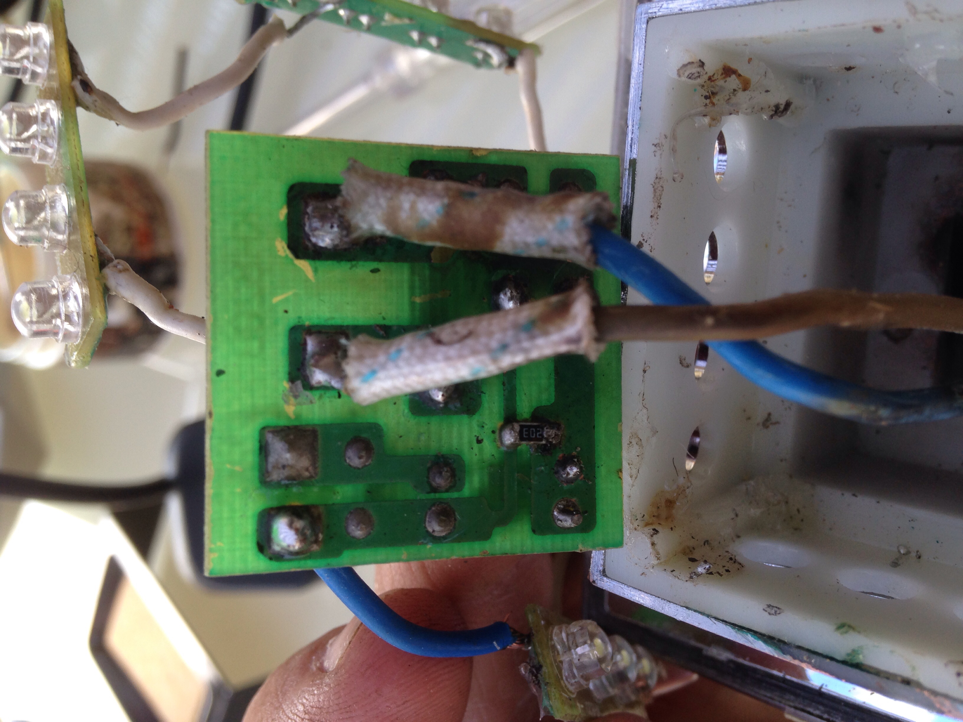

Could we see a picture of the board please? Preferably a top-and-bottom view.
here we go!

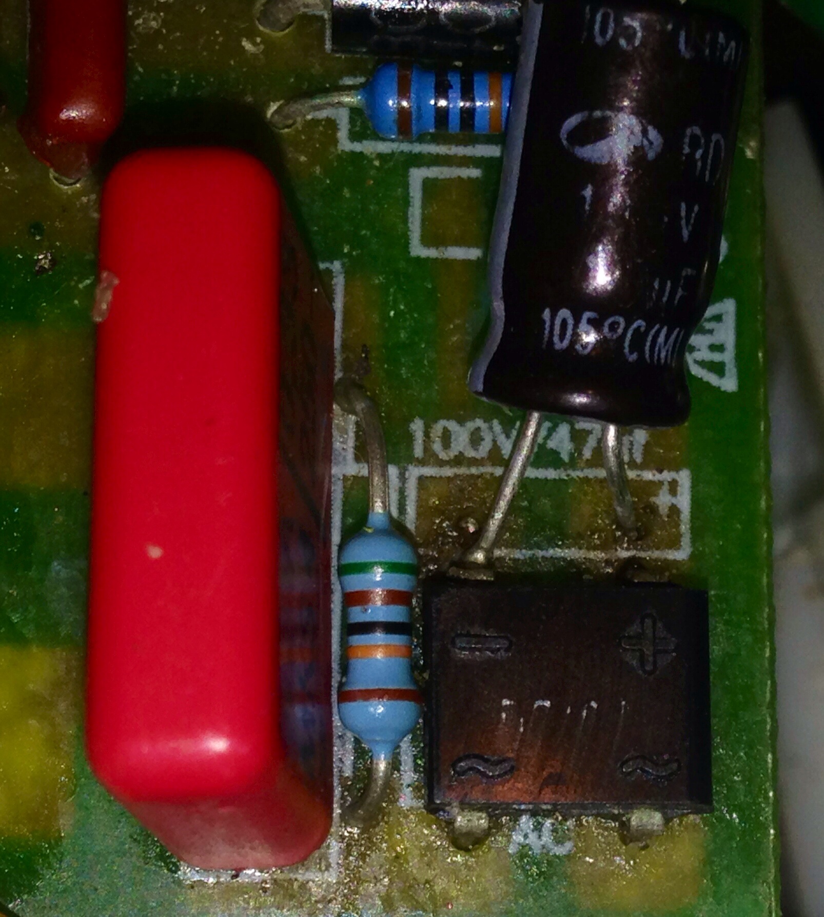

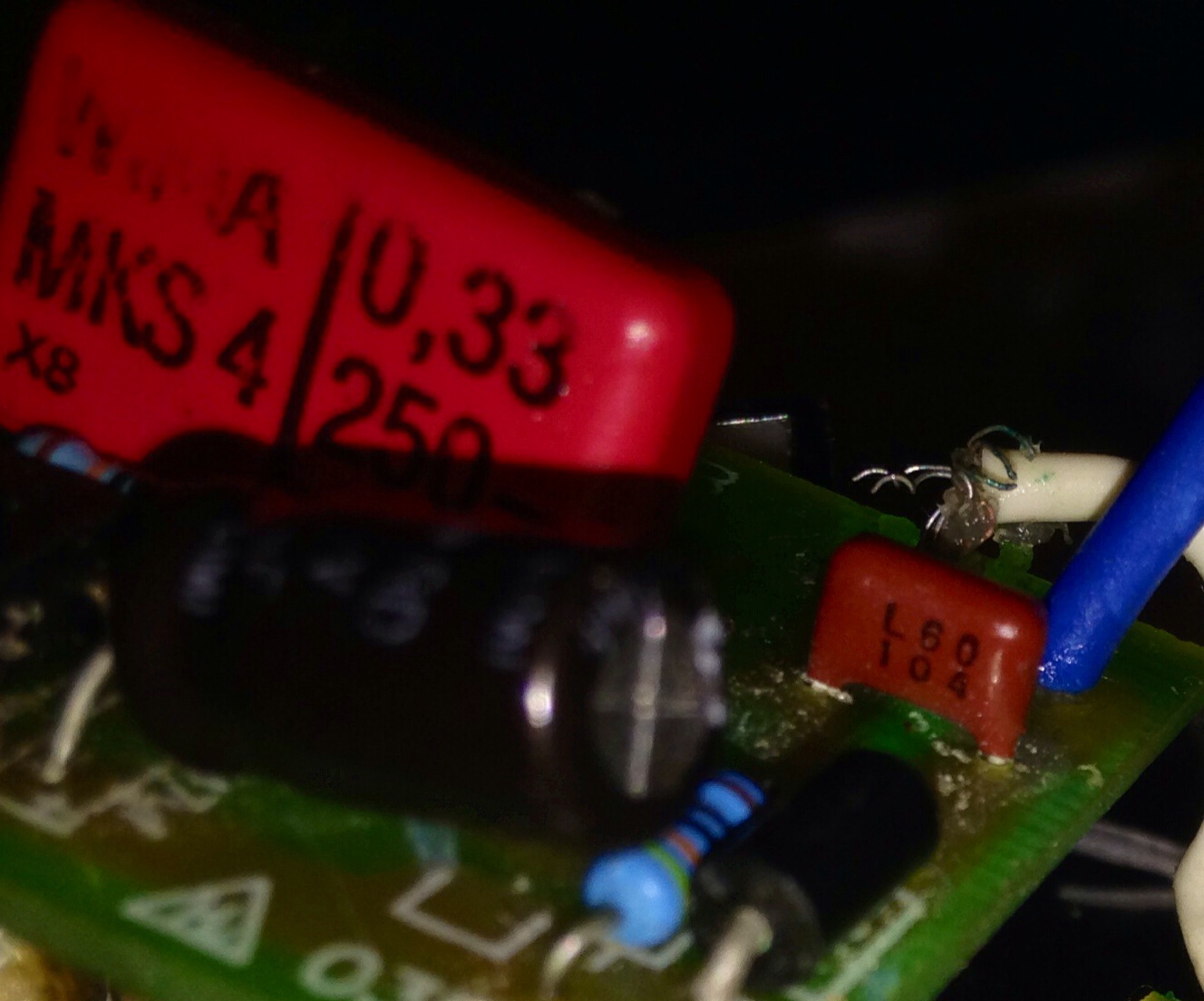

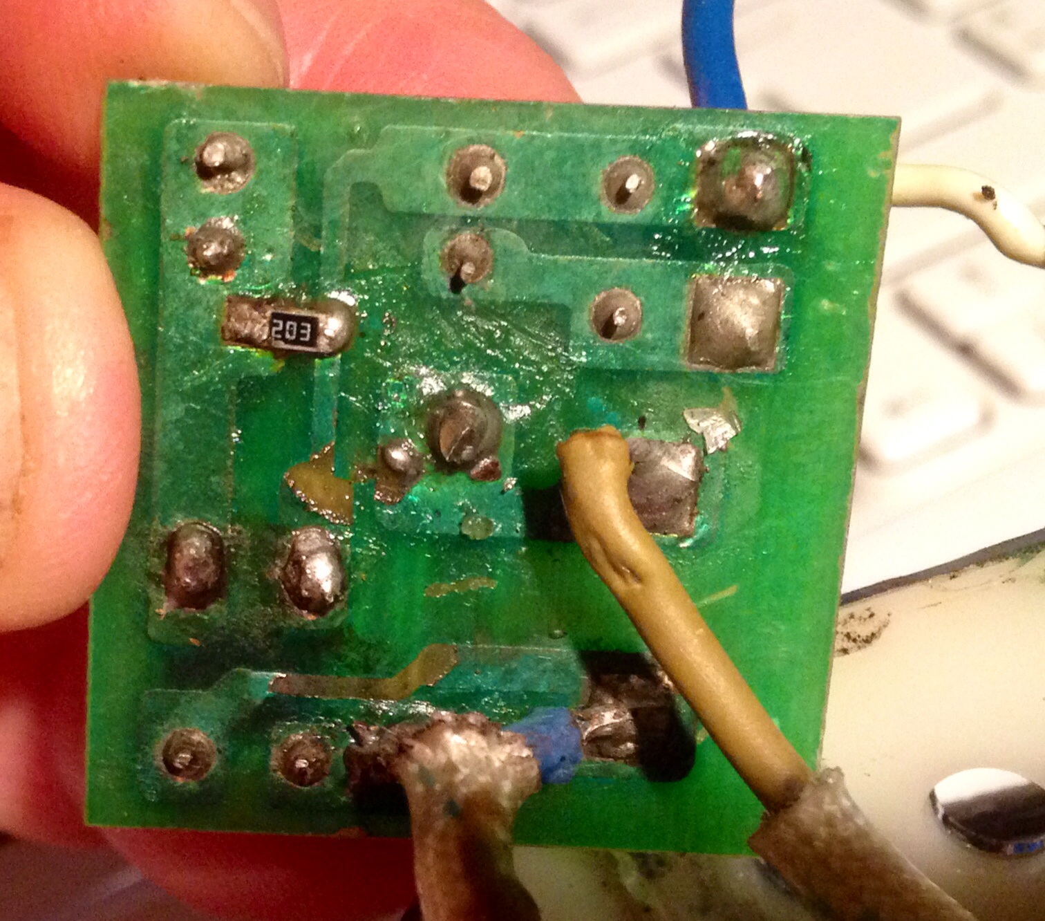

Unfortunately the second pic is rather blurred. What ID is marked on that square black component top left of pic? What markings are on the black component (looks like a diode) at bottom left?
I don't know about shorted, but it does look like it got wet and corroded some of the contacts and traces.

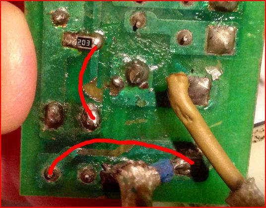

Try running insulated 18 or 20ga jumpers where the red lines are in the snip below, to replace what appears to be blown (or corroded) traces.
CAUTION: make absolutely certain that there is NO POWER to the board when you attempt this repair. If you do not know how to assure yourself of the electrical safety of the repair, do not try it.
This repair might not fix the problem since there's no assurance of what damaged the traces in the first place.
But it looks to me as though the trace damage was most likely "short" related. Let's hope it was mechanical and not component related.

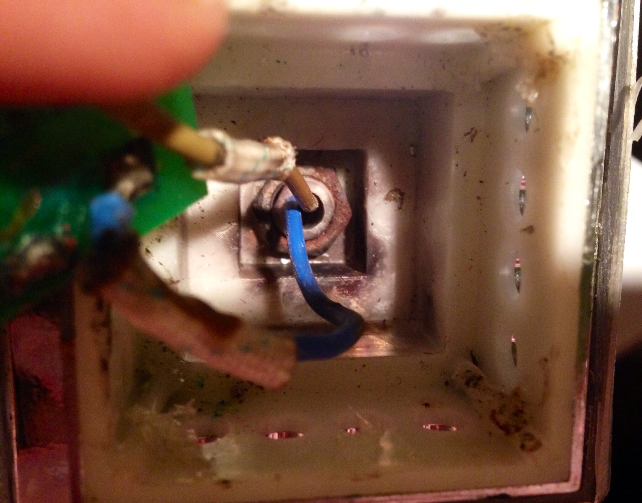

The white wire end shown in post #6 has loose/broken strands which could have shorted somewhere. Tidy up the connection.
The insulation on the brown (live) wire is dented. Make sure there is no metal showing through it. Replace if doubtful.
If the suggestions don't get it working and you have a multimeter, you could disconnect the 'good' light and compare resistance values of its components against those of the faulty light to identify any fried component.

The PC trace acted as a fuse and when you replace it with a wire of a larger cross-sectional area you lost that as an ersatz "fuse". So, I'm saying a fuse and and some sort of transient voltage suppressor would not hurt.

You could see the teeny metal globules at the edge of one of the traces that indicated the "fuse" action of the trace.
