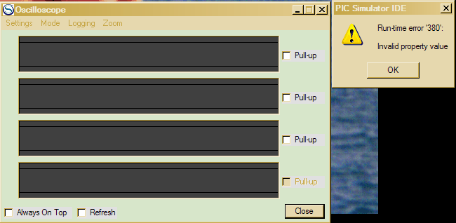

I am using XP Pro with Oshonsoft.
I have noticed that for the past 3 simulator upgrades that the Scope Tool when selected creates a Run time error 380.
If accepted the program closes down.
This is happening on two different PC's using 16F and 18F IDE's, it does not happen when using the 10F version of the IDE.
Also the micro-controller window is not auto restarted when the IDE is started up, for 10, 16 or 18 IDE's
Anyone else see this or other problems on these upgrades

I have 16F version 6.96 in Xp and have the same problem.

This is the reply I received from Vladimir, its fixed the Error380 problem.
In the Links below, enter your email address that Oshonsoft has on record.
E
COPY:
Hi Eric,
To get rid of the 380 error you need to perform the following:
- Using regedit.exe application delete the key:
[HKEY_CURRENT_USER\Software\PIC Simulator IDE]
(regedit.exe can be found in C:\WINDOWS\ folder, or you can
run it with the Run Start menu command by typing regedit.)
Now, please install your license again using the instructions
from the official license e-mail.
For your convenience, I have just sent to you the official e-mail
with your licenses, so you can keep fresh copies on file.
Stay well and best regards,
Vladimir
