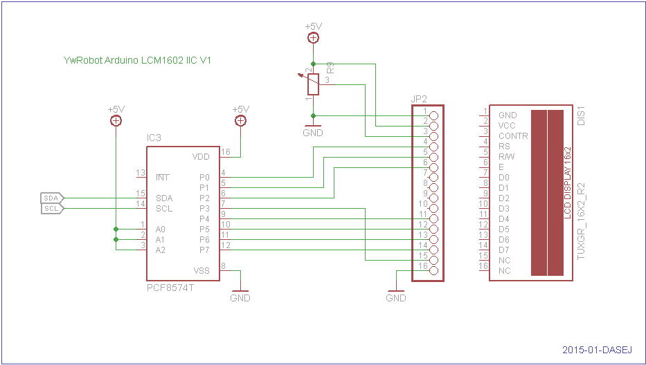

Hello. I am using the Oshon PIC simulator IDE and trying to write to a 1602 (16x2 line) Liquid Crystal Display. The interface is via an I2C 4-wire connection. The command that I trying to use looks like I2CWrite sda, scl, 0x4e, addr, data (where 0x4e is the I2C address). I just can't get it to work. Could anybody help me please? All I need is an an example of how to write 0 to the first character of the first row and I can take it from there. Many thanks

Okay... A bit of research done... The I2C chip is a PCF8574 Address is normally 0x27 so shift left 1 = 0x4E.. so you are correct.. Sorry but I need all the information...
Now... It is a serial shift register so you will need to write a few routines as it's not quite so straight forward..
Is this the circuit on the back of the LCD
You will need to write several times to get it initialised and a few more to write to the screen..
Thank you again Ian. Unfortunately the circuit is not as you have shown it. There is a lot of documentation and code for where the PIC is connected directly via the data lines to the LCD. Unfortunately, I'm trying to avoid all the wiring by using the I2C interface. This connects to the LCD panel and has a 4-wire connection to the PIC (SDA, SCL, GND and VCC). The simplicity of the wiring is negated by the complexity of the coding I suspect!

Do me a snapshot of the backpack so I can see how it's connected..
There are one or two different types.... As your I2C address was 0x4E I just assumed PCF8574... The circuit above is the normal connection!!
Hi Ian. In actual fact I am making use of a PIC board previously connected to a RTC so I know that the board itself works. It uses a 16F876A (old technology I know!) which has a 4MHz crystal. Although you assumed a different processor the connections are actually the same. RC4 (pin 15) connected to SDA and RC3 (pin 14) connected to SCL on the I2C interface on the Liquid Crystal Display.

EDIT2: If this is the backpack, there are 6 solder blobs above A0 A1 A2 beneath the blue pot - are any bridged?
Another possibility is whether a PCF8574 is used, or a PCF8574A:

The chip on the I2C interface card is a TLPCF8574T as you thought. A photo is attached.
I have noticed that in your circuit diagram you have pull-up resistors on the SDA and SCL lines from the PIC. I don’t have them so do you think that could be the problem?

Don't want to interfere but does not the I2CWrite command shift the 0x4E <<1 ?
No! Vladimir makes you do it manually.. I have tested my code and it works as it should.
I think Arduino platform does... I definitely know the .net framework shifts it as well..
Hi Ian. Alas I still can't get it to work with the new code. I've tried adding two 10K pull-up resistors and also a different LCD/I2C interface. All that happens is the display flashes for a fraction of a second and then the light goes out.
I'm taking up too much of your time now so I will not trouble you again. Thank you so much though for all your help.
