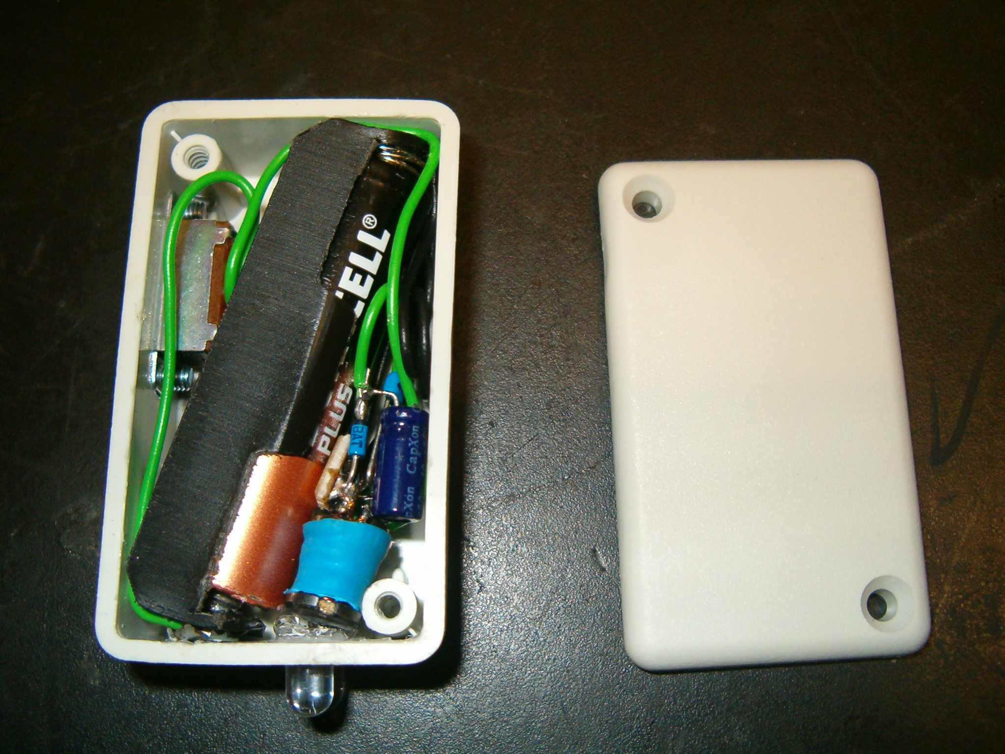

And as for using a 'scope to repair a torch, I have one I use a lot that spent some time on the end of my scope, here it is:
A ubiquitous joule thief, its been used the last 3 years while working on and fabricating industrial machinery, so it looks a little worse for wear now.
