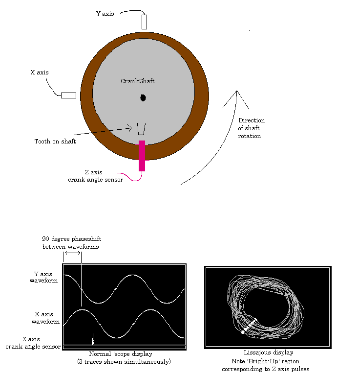

The one application I can think of where it is used is in rotating machinery vibration diagnostics (still reading? good - stay with me on this...)
Imagine an engine (a car engine will do ). The crankshaft is rotating at some speed - say 3000 rpm (50 cycles per second, 20ms per cycle).
I want to measure the vibration of the crankshaft so I have installed two probes at right-angles to each other (see drawing), both watching the shaft move, one in the 'X' axis and one in the 'Y' axis.
If I connect these to the 'scope's two channels and switch the timebase to 'CH2' or however your 'scope displays Lissajous figures the 'scope display will start to scribble a rough cicle in the middle of the screen, the shape and size of this circle is proportional to the movement of the crankshaft (see attached drawing).
This is great if you just wan t to see how well the engine is balanced or how much play there is in the bearing but you can estimate the amount of unbalance in the crankshaft and where to fit a balancing weight if you can relate this display to shaft rotational position.
By adding a third probe (crank angle sensor?) to look for a single tooth on the shaft you can see a breif pulse as this tooth passes the probe. Use this to drive the Z-Axis and your lissajous display suddeny has a 'bright-up' on it showing exactly how the shaft moves and allowing its angle to be seen.
