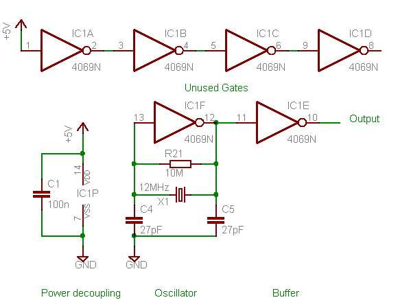

I had a similar situation, and used this cct. to measure the frequency of a crystal. BTW that case is a crystal, not an oscillator. :)
I directed the output to a frequency counter, if I recall.... so long ago!
I figured I was going to call it the wrong thing. In my head crystal and oscillator are the same thing... although I should probably learn the difference. :)
That circuit makes no sense to me and being that I just found this crystal lying around, I don't think I want to make a whole circuit just to see what frequency it oscillates at. Thanks a lot for your time and help though. I really appreciate it. I was just looking for a more basic solution.
How many pins does it have ? If only two it is most probably just a crystal. Crystal oscillators usually have at least 3 connections - ground, power and output - but can have more (for example if it is a VCXO).
