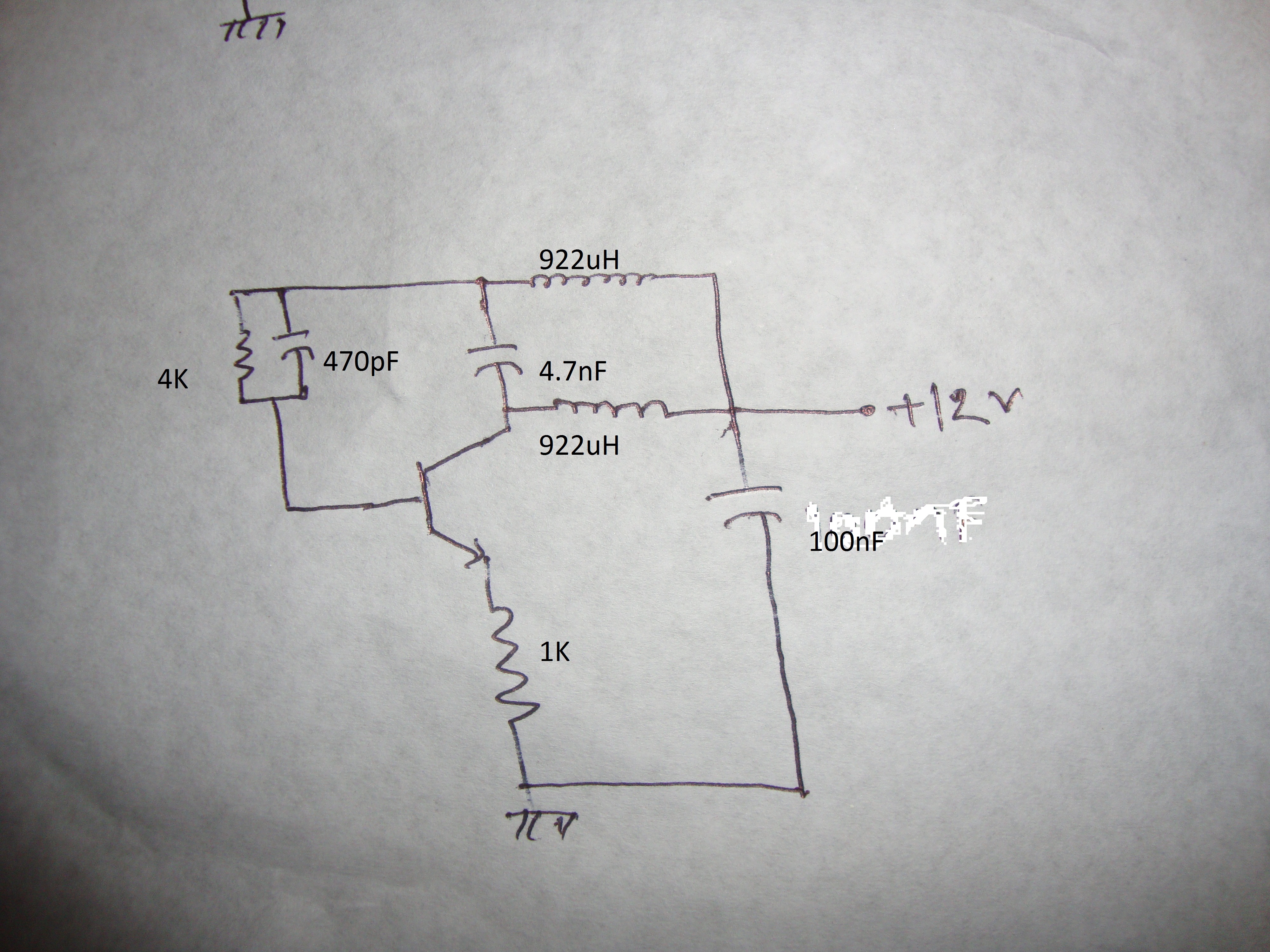

oscillator
I am a undergrad student.I have a problem with a oscillator circuit.I have found a oscillator circuit from net and using it as a oscillator in my circuit.But my problem is that i could not find that what type of oscillator it is and what is it's operation?It would be helpful for me if someone please help me to know the type and operation of the oscillator .Thank you.I have given the figure attached.

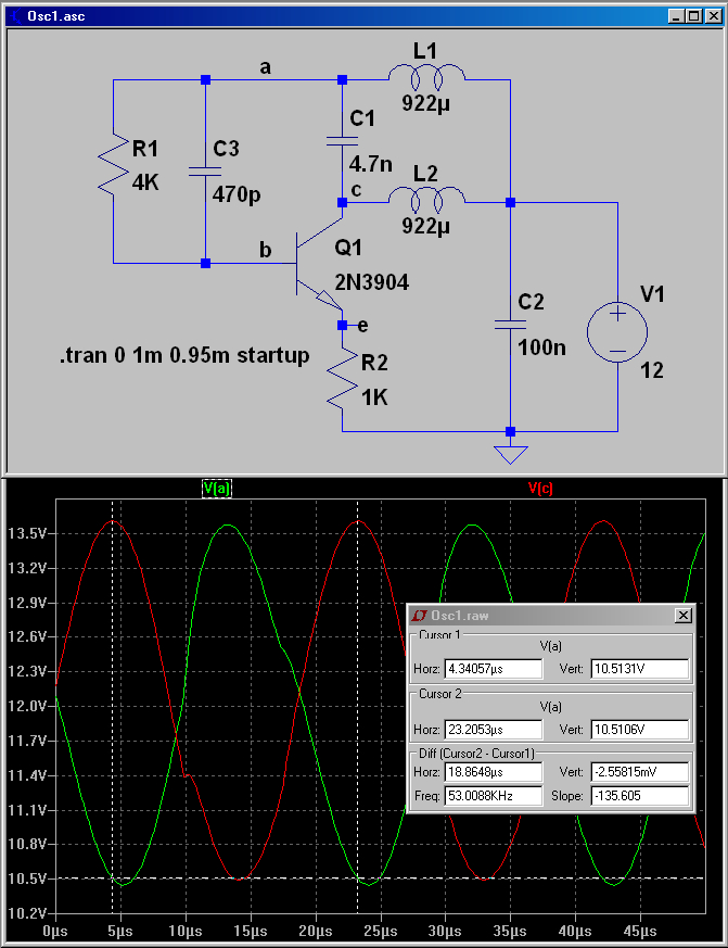

Not a particularly good one. Here is a sim of it. Note that V(c) and V(a) have approximately equal amplitudes, but they are 180 degrees apart. This shows that the network consisting of L1, L2 and C1 is a Pi-section high-pass filter which has a gain of ~1 and a phase shift of 180 degrees at the frequency of oscillation.
If the transistor has a gain of slightly greater than -1, then the circuit will oscillate, which it does. Note the un-bypassed emitter resistor, which is why the transistor gain does in fact have a low gain. Also note the low amplitute, and the harmonic distortion.
I have never seen this circuit before, but I would call it a variant of the Colpitts Oscillator.

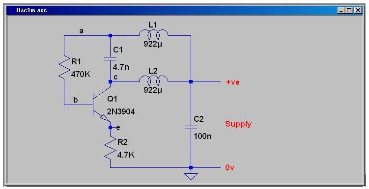

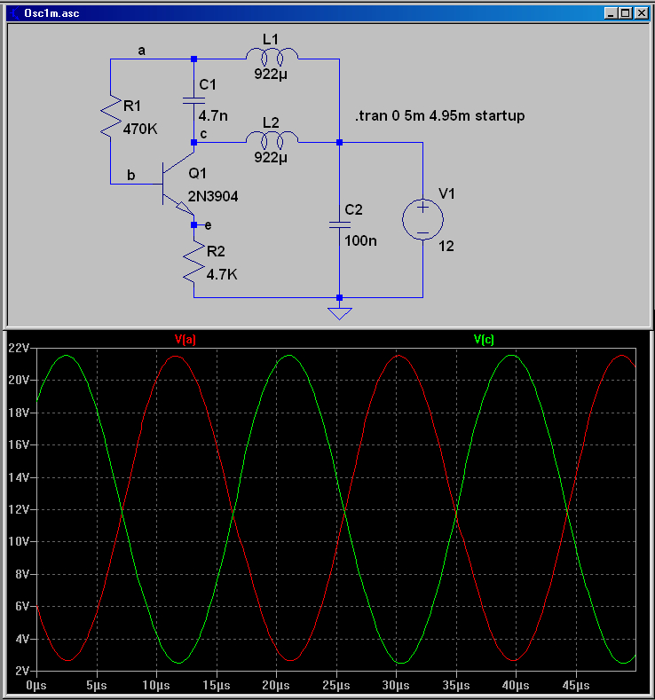

I played with the bias, and came up with this: Higher amplitude and lower harmonic distortion.

I am actually confused about what type of oscillator it is about about how it is operating ?can you please tell me how it is operating ?
If you do not know how oscillators work, Google Barkhausen Criterion and the Colpitts Oscillator. Read the Wikipedia entries on both those topics.
I agree that it is a strange circuit which I dont think that I have seen before.
However, because it is using a tapped* inductor, it looks to me to be more of a variation of the Hartley oscillator.
*But then can the inductor be said to be tapped when there is no obvious mutual inductance between the two coils?
However at resonance, it should give the required 180deg phase shift for oscillation (The transistor providing the other 180deg).

So sir what do you suggest that what type of oscillator it is?As I am not expert I am not understanding the operation?
There are two basic ways to accomplish the feedback phase shift. One uses a split capacitor which is in the Colpitt class. The other is using a tapped inductor which is in the Hartley class.
This particular uses the two inductor as a center tapped coil (presumably without mutual coupling between coils). Loosely I would put it in the Hartley class.
So what is the operation of this oscillator?I am not understanding how it is operating?But it is giving good and stable frequency.
Using an edited version of one of Mikes simulations:
Resistors R1 and R2 set the DC operating conditions for the transistor.
The Collector of the transistor gets its DC supply via the inductor L2.
Editing here:
(for the second time, because the first edit just dissapeared into the bit bucket!)
L2 provides a collector load which is very low resistance at DC and equal to the reactance of L2 at the operating frequency.
This statement is over simplified and is just plain wrong. What I should have said is:
The collector load for Q1 is provided by the overall impedance of L2 in parallel with the series imedance of L1 and C1.
The resulting impedance will be a maximum at the resonant frequency of the tuned circuit, and lower at all other frequencies above and below the resonant frequency.
This gives the amplifier maximum gain at the resonant frequency of the tuned circuit.
End of edit.
Capacitor C2 decouples the DC supply so that no AC can exist on the supply line.
The transistor is in a common emitter configuration, and so a signal at the base will be inverted at the collector (ie for a sine wave it will be phase shifted by 180 degrees).
The tuned circuit comprising L1, L2 and C1, at its resonant frequency the voltage at point "c" will be phase shifted by 180 degrees compared to point "a". This can be clearly seen from Mikes simulation plots.
The DC supply to the base of the transistor is via L1 and R1.
When the circuit is oscillating there will be an AC signal superimposed on the DC supply to the base.
That signal to the base will be 180 degrees phase shifted ffrom the signal at the collector.
So, we have 180 deg phase shift in the transistor, 180 deg phase shift in the tuned circuit, so the feedback signal is in phase with the original signal at the base, and provide that the gain around the circuit is greater than 1 at the resonant frequency of the tuned circuit, we will have a sustained oscillation.
I think that just about does it.

Sorry for the highjack, but Mike would you mind posting the sim please? I am trying to learn LT spice, and I would like to play with the sim a bit. I tried to copy it but didn't get it to work, so wondered if you would post it so i can look at how you did it.
Thank you
