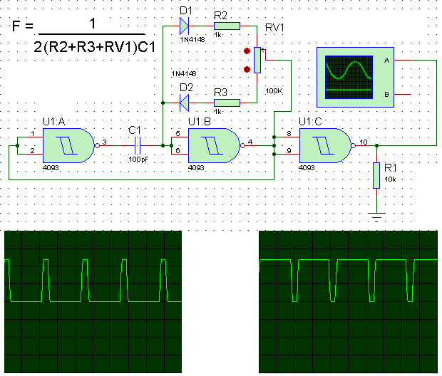

I am am building a oscillator circuit for testing different transformer designs. I need the the freq to be idependent of the dutycycle adjustment. For testing at a certian freq say 50Khz, I would be able to select the best dutycycle for the given transformer design, at 50khz. I was thinking of using a PWM controller IC like the TL494. Instead of using feeback from the PS output I would use a pot with a V.D. Any ideas on how I could achieve my goals?
This could be used as your generating part. You can easily drive another switching device to enable you to switch a transformer winding. The frequency shown is about 50kHz, with the scope showing the min and max duty cycle (without any significant frequency variation) according to the position of the pot. The 2 fixed resistors limit the min and max settings.

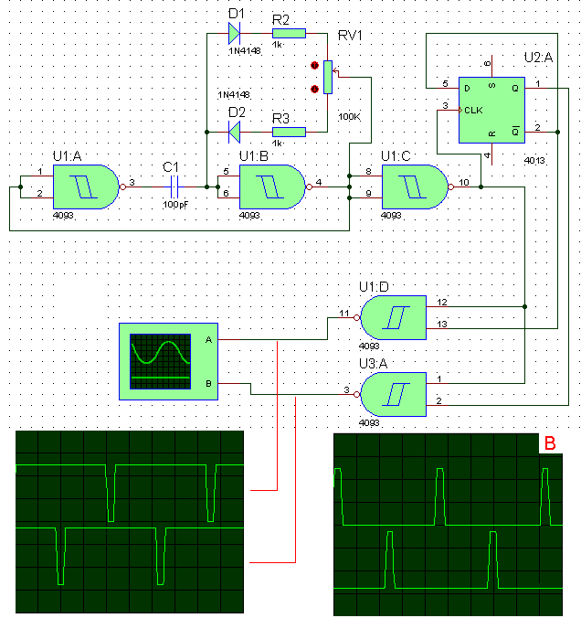

If you need signals in anti-phase for example push-pull drive, you could use the circuit modified as shown. You need to insert 2 more inverters, one in each line if you logic is active High (B). Also (remember to double the switching frequency F) :eek:

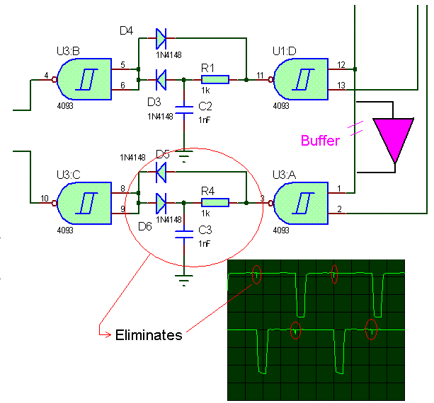

The following modification to B will also add some dead-time to prevent glithes on the output, because of the possible "race problem" when switching. Yet another way (without the diode-cap-res) is to create a delay with inserting a buffer (2 x 4093's in series) in one leg as shown.
