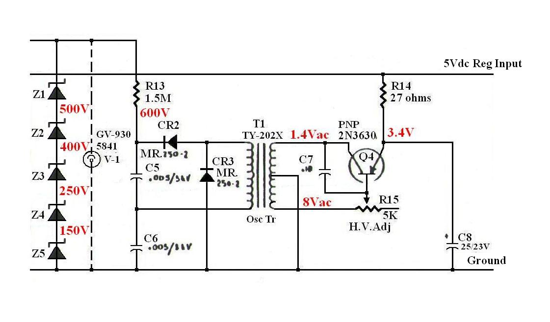

I am hoping that someone could tell me what it is; oscillating transformer.
I have a transformer, centre tapped on primary side (3 wires like a voltage divider). Input is 5vdc regulated and secondary was about 700vdc (2 wires) when coupled to circuits.
When not coupled to circuits, input of 5vdc register 36vdc on secondary.
My question is
- how was the voltage raise to that level? There is 2 diodes tied to the secondary side.
- in what way can I make identical transformer? I don't have any specifications other than
measuring voltages from a good working ones.
- if it oscillate at 1000cps, does it mean 500 cycle/sec (500hz)
Thanks in advance.

Thanks for the respond. I have attached a drawing of the said circuits. I'm not sure if it's a push-pull converter as Mike suggested. Oh yes MIke, thanks for the attached reference you include. It helps me to understand more.
Since transformer are base on mutual induction of alternating current, there is a capacitor tied to the input side of 5Vdc reg supply.
dr pepper, I'm trying to make a similar oscillating transformer (that's what the manual refer it to) base on existing working ones.
Thanks again guys. Appreciate it very much.
Not a push-pull, but single-ended. C8 is for bypass, energy storage. R14 is for voltage drop and filtering. Q4 makes a blocking oscillator with out-of-phase feedback from lower half of the transformer primary. C7 affects frequency, but is there mostly for spike suppression. R15 affects amplitude. CR2-3 C5-6 form a voltage doubler (reduces necessary turns-ratio in T1). R13 Z1-5 form a shunt regulator.
This supply delivers high-voltage, but only a tiny current.

A classic blocking oscillator, or as now popularly called 'joule thief'
If you can get the same trans then you'll be able to make a copy, even if you cant its still workable, if you can still get the data for the original trans you ought to be able to get something similar, blocking oscillators are usually forgiving on parameters.

Thanks again guys. I follow up to the patent literature Mike and found the origin of the text. The trans was meant for flickering neon light for it's high voltage output. Now for my attempt to make a similar trans, the transformer maker needs spec such as VA, input and output voltages. With info of Primary secondary turn ratio 1:200, primary winding feedback of 50:1, input voltage of 5Vdc, would that be sufficient spec? I measure a working trans an inject a 5V on the primary side, without connecting any other component, what I get was 36V on the secondary (open circuits). This info, will it be sufficient? What do you think guys?
Possibly, allthough I'm not sure I get the 50:1 on the feedback ratio, are you saying the driven side of the primary has 50 times the turns as the feedback side, that sounds a bit high, but if thats how the original is.
5v to 36v might well be ok if you measured the trans with a sig gen or the like, being effectively a switcher turns ratios as per classic mains trannys dont apply in the way you think, in the application there will be more on the 5v side due to flyback.
The winders will need to know the max voltage on the secondary and the difference between that and the primary insulation wise, and they might need to know the max operating temp for the insulation, operating frequency is also important and maybe too duty cycle, ie how longs its going to run for at a time.
I didn't get the 50:1 feedback statement in the patent, either? I have built blocking oscillators like this one where the primary was just a simple center-tapped winding. In other words, there are an equal number of turns on either side of the center tap.
