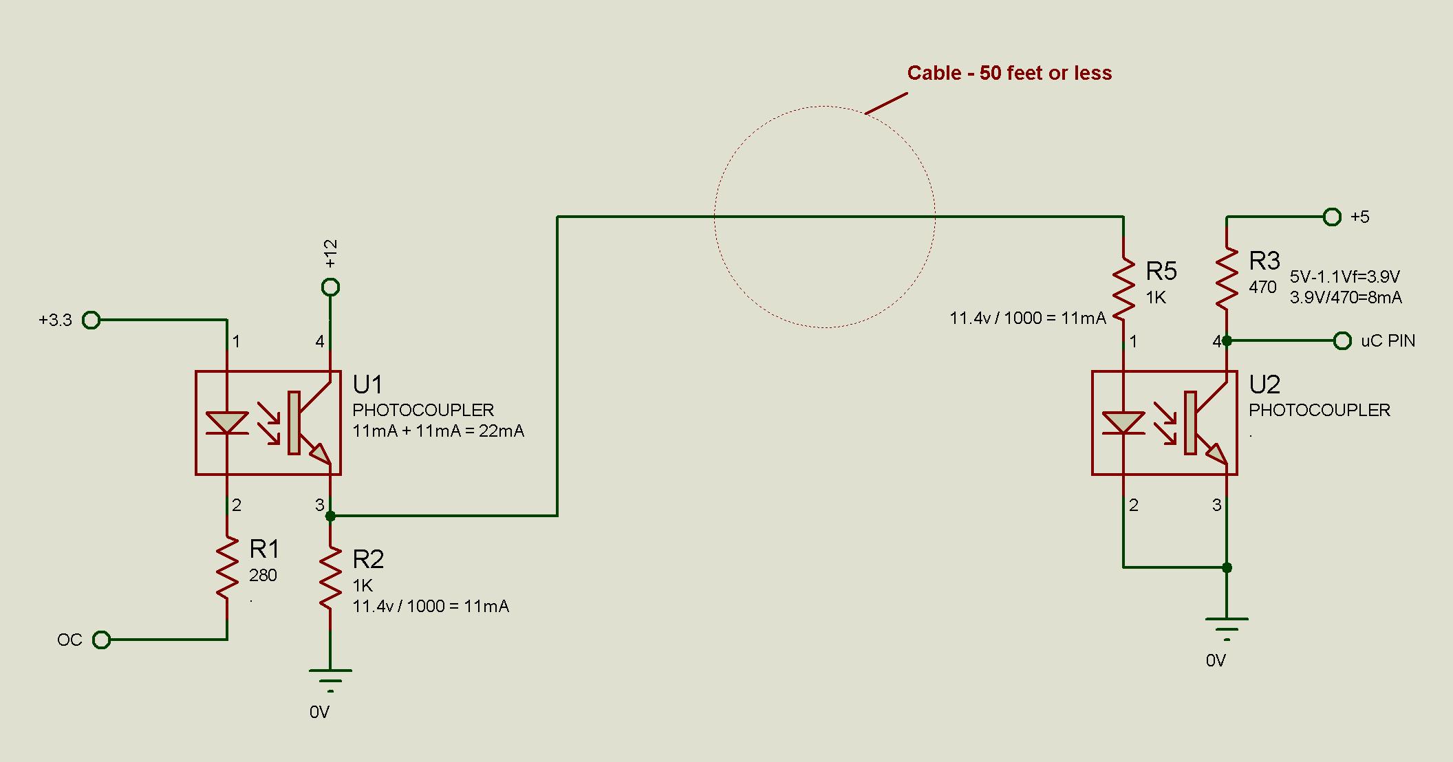

Revised sketch attached. (Like that?)
The connection is via 7 core shielded cable.
This is an equipment monitoring control system. The host controller is indoors connected to an RF transmitter. The transmitter does not have enough power to remote it from the (patch) antenna more than a foot or so, so the transmitter has been integrated into the antenna housing. The antenna housing must be outside under open sky.
The transmitter communicates with the host controller at 9600 baud, 3V TTL. Using a MAX232 on both ends to convert to RS232 to beat the distance, improve the SNR, and make the transmitter able to communicate with a PC for other implementations. Similarly, I would like to step up the OC signal for the trip down the cable. The transmitter runs on 3.3V, the micro-controller runs on 5V.

The OC indicates modem status, it goes to an input (via another isolator) of the micro-controller. In the scenario where it communicates to a PC, I would run it to the RS232 RI pin.
Not using twisted wire, didn't feel it was required using shielded at 9600 up to 50'.

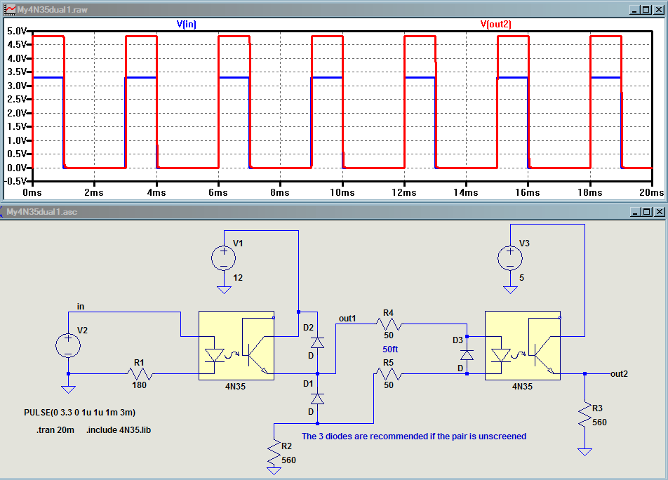

hi.
I think I follow your description OK.:)
As you have free wire pair I would suggest if you are using the emitter follower output of the sender opto, that you break the emitter to 560R connection and insert the open end of the pair between the emitter and 560R.
At the receiver opto connect the pair across the opto diode.
This will provide a path for the from the sender opto to the receiver emitter.
Do you follow or would a diagram be helpful.?
EDIT:
This circuit is one option

hi Carl,
I know that it dosnt matter in most cases, I was a little concerned about how the 50ft cable was going to be connected to the remote via the 50ft.
Look at the option circuit I have posted.:)

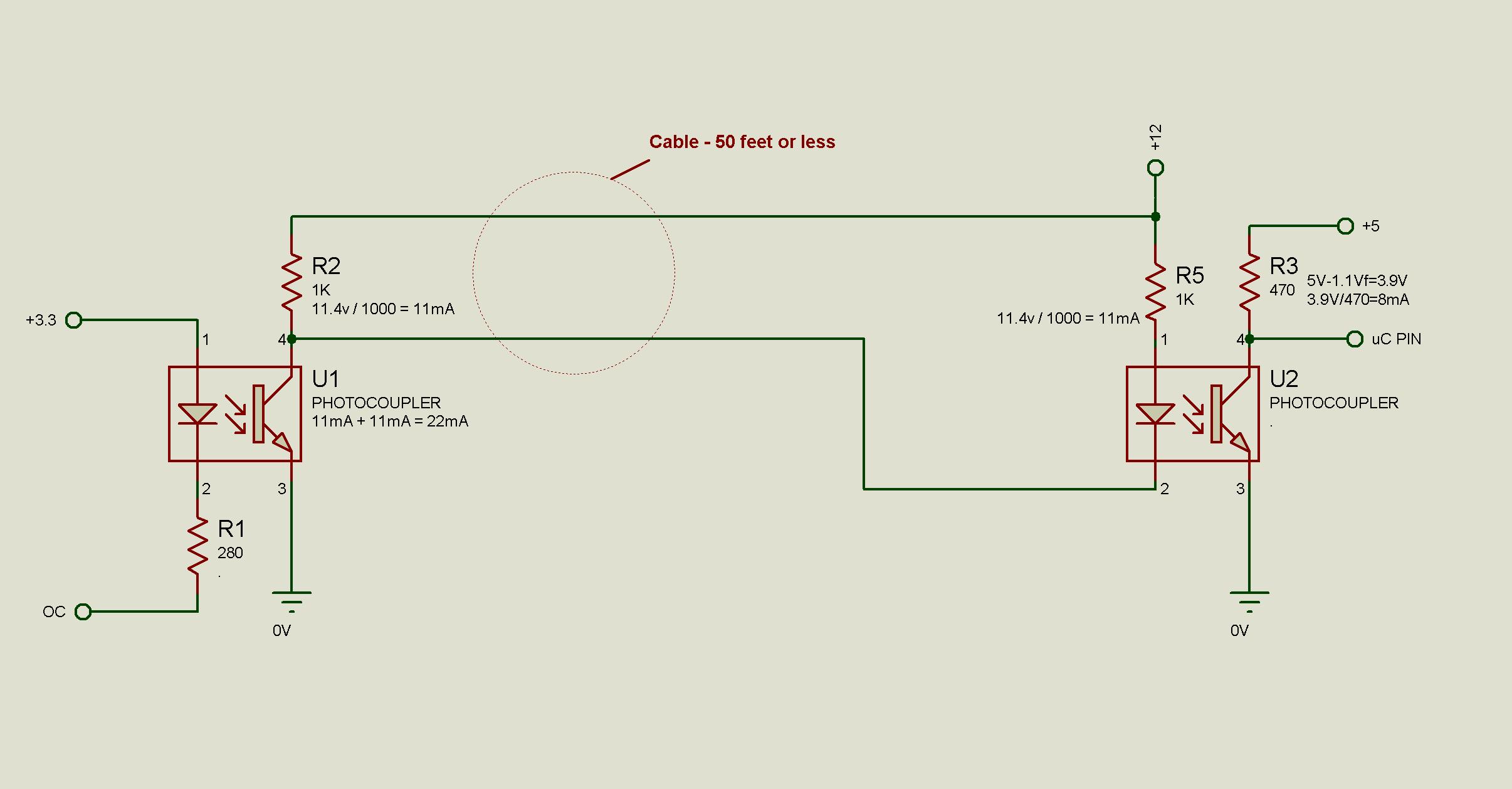

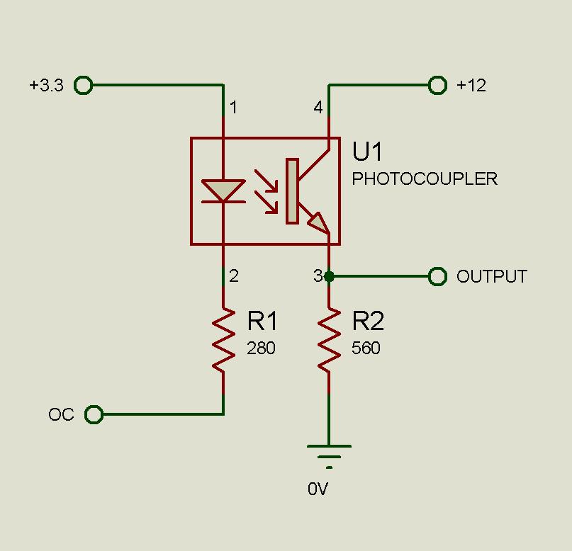

I think I follow, but it is important to maintain compatibility with standard RS232 to a PC if needed down the road. I would like to have 1 pin which is 0V or 12v which I could run into the RI (ring indicator) pin on a serial port of a PC.
I'm assuming I could use the pin to sink current to the cathode of the remote opto? See attached....

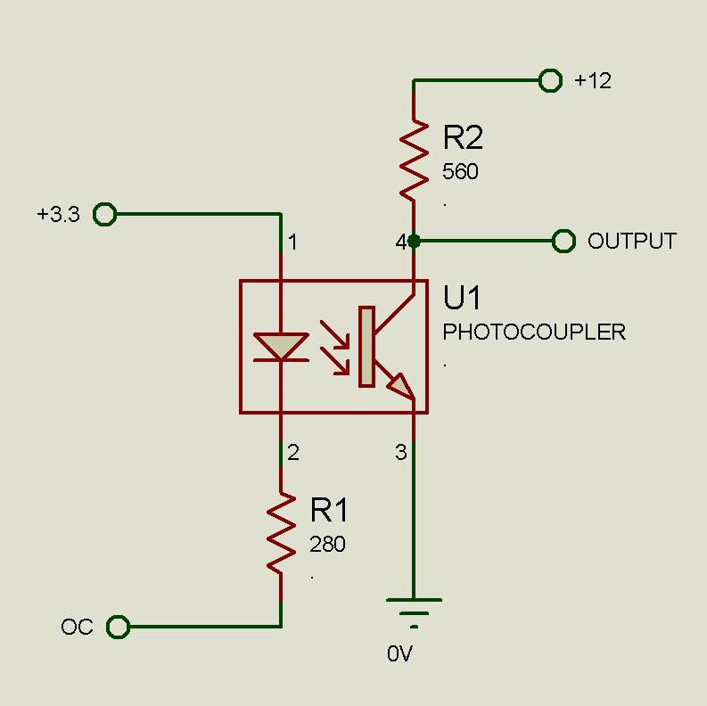

how about...
I think I like this way better.....
Output wouldn't be inverted.

Hi Eric,
Just noticed your drawing. Makes sense, but I'm not clear on the reason for the diodes if unscreened. Are they to shunt out noise?

I prefer to place the current limiting resistor (R1) between the Supply voltage (3.3V) and the Opto's anode. The Opto operates the same but this orientation provides a little more safety when testing or troubleshooting.
As it is now, if someone, while probing the circuit with a meter or scope, accidentally grounds the cathode of the Opto, it could be damaged or destroyed. If the resistor is placed as suggested the Opto is protected from accidental short circuits.
