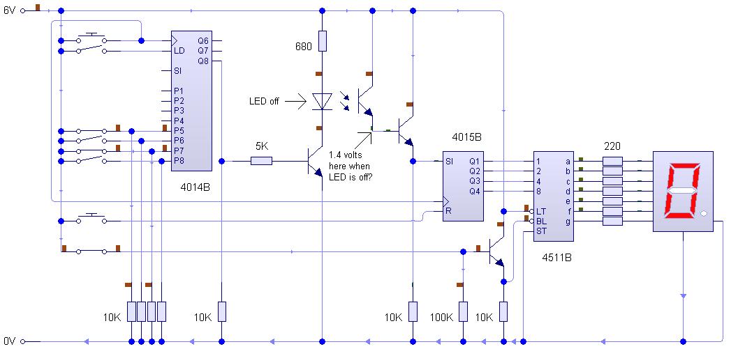

i have included in this post the problems that i have on a word document. i have done this because it contains pictures that are related to the text and i didnt want to post them seperatly, i will host them online and link them here if necessary or requested. a quick run down of my problem:
the opto isolator contains a LED which is used to transmit data and a Phototransistor to recieve it. this phototransistor is set up in a darlington pair array so it has the base of another transistor coming from the emitter of the phototransistor. this is sealed withing a unit and cannot be modified. basically in simulation when i connect these transistors to high and low along with my output the transistors are always on, the output from the darling pair that i use is always high. why is this? when i tried with two regular transistors this didnt happen, is it to do with the phototransistor? is it to do with the simulation? any advice on this would be great, see the word document for better details and pictures.
i have also included my circuit diagram if you wish to look at it, any critisms would be fine. it is important to note that the switiches will be replaced with outputs from a pic chip. on that note, do i need to pull down the outputs from the pic and if so would it be any different from pulling down an normal input (as shown here). also would it be a good idea to put resistors protecting the inputs of the 4014b and 4015b chips so the curent isnt drained into them?
No, because the PIC outputs can both pull UP and DOWN by themselves.
The reason you need the pulldown resistors in the diagram you submitted is because your switches only source voltage and don't have any means of sinking current to ground. That is what the pulldown resistors are for.

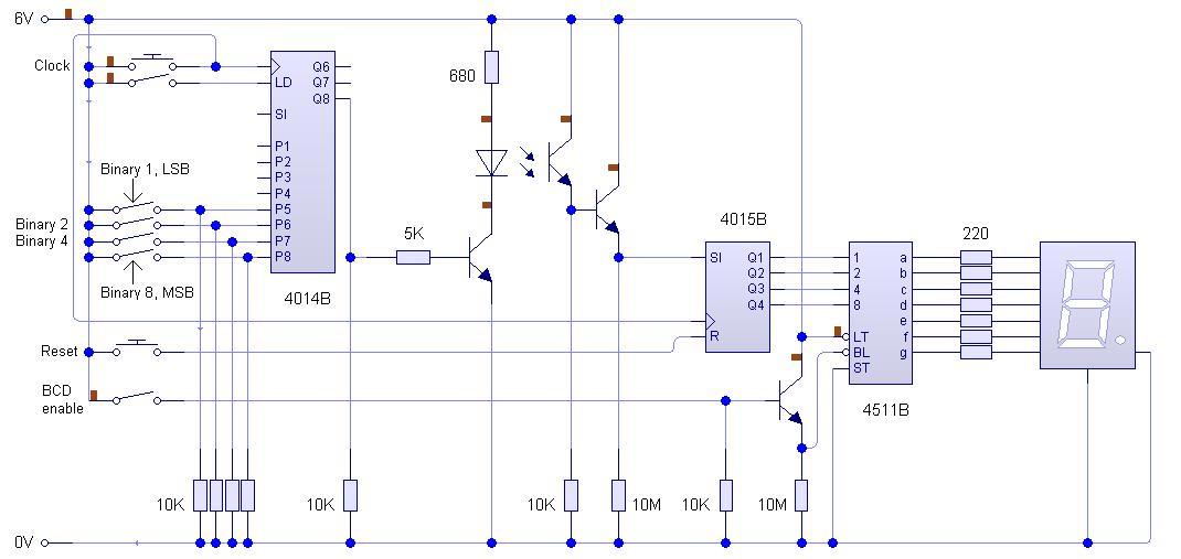

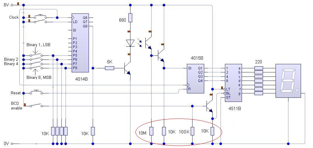

I have attached a modified version of your diagram. I've changed the values of some resistors. They are circled in RED. See how that effects the SIM.

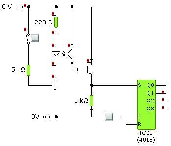

oh right sorry i forgot to mention that one of the resitors on the diagram cannot exist in real life because it is connectied to a transistor which is inside a component, so it cannot be reached. i have included an updated diagram with your changes but without that resistor, it does work in simulation but i am still getting a a voltage (of 1.4 volts) on the emitter of the transistor which i have highlighted in the diagram. while this appears to not be a problem, does anyone know why it is happening and how i can get rid of it completely?

oh and another solution i found was to make the resistor connected to ground from the second transistor on the darling pair only 1k, this made the voltage when the led was off something like .6v which would appear as logic 0 to the 4015b chip.
This is probably caused by a poor simulation of leakage current in your opto-isolator. Don't always trust what a circuit simulator tells you.

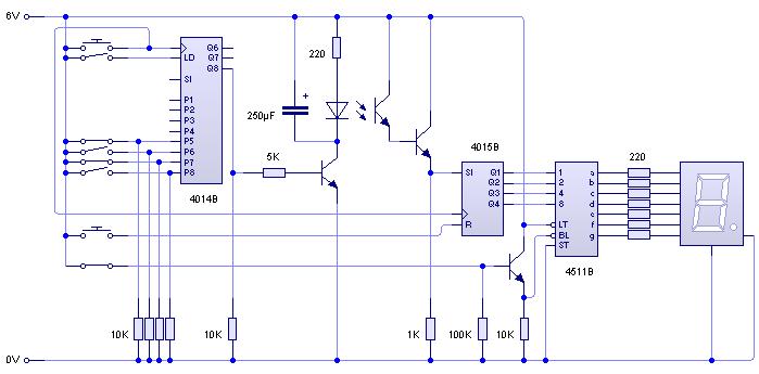

i did concider the fact that the LED would switch off before the 4015b could register it and im thinking about how i could solve this. one solution i had would be to use the extra output on the pic im using to have two seperate clock inputs and the other was to put a capcitor across the LED and resistor so it discharges slowly (about .5 of a second). anyways ive inlcuded a picture of my edited circuit diagram, in simulation it works, i was wondering if there would be any problem with this is should be aware of. is the calculation for time delay in this circuit R*C?
i dont need to worry about outside interferance because i will be using it in a dark room
Why not do all the bit banging with the PIC and do it using an asynchronous serial stream. This will also save IO pins on the PICs and you can build in an error correction system too.
-=GST=- Nemisis (cs/cz) said:
i dont know what you mean? could you give me an example? anyone please im supposed to be programming the chip today and any changes need to be done soon!!!
Personally I don't have the faintest idea what you're trying to do?, you keep mentioning PIC's but then show some bizarre CMOS circuit?. Assuming you're wanting to transfer data between two PIC's?, you just need an IR LED on one, and an IR receiver IC on the other, everything else is software - and covered in my tutorials.
heh yeh maybe i have explained this poorly. also this is a rather pointless peice of equipment and i keep finding solutions to my own problems so each time i re-post its different sorry for being missleading. i have solved my problem though with the assyncronous clock pulses so thats some good news. if i have another problem i will explain what im trying to do better and repost thanks for the help anyways!
