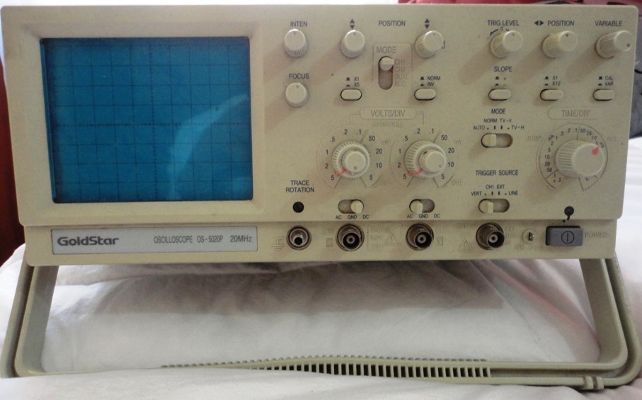

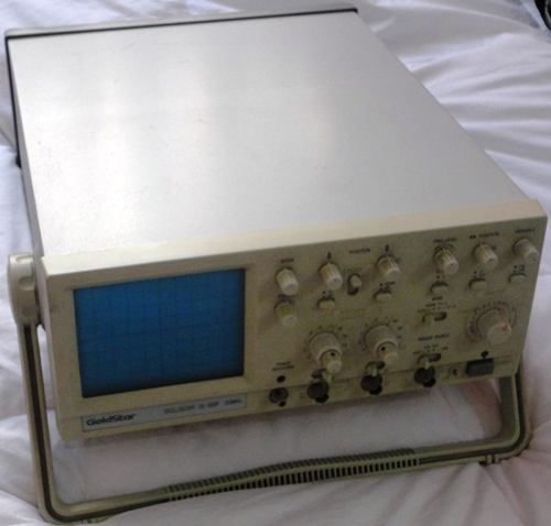

Hello guys
I read that an oscilloscope is a must for any serious electronics enthusiast, so I started a quest to get one.
I found an ad of a GOLDSTAR OS-5020P, 20 Mhz, without probes. It costs $280.000 COP or 280 USD* I understand that getting an used oscilloscope on a first world country is extremely easy, but here the options aren't so extensive.
- Do you think that it would be a good choice for a beginner?
- What do you think about Goldstar construction quality?
- The Ad says it's non calibrated. Is the calibration process something that the user can do, or require specialized personnel and equipment?
Yes, maybe.
It has all the basic things for a two channel scope.
I cannot comment, I have no experience of Goldstar.
"Not calibrated" could have two rather different meanings:
1 It is working correctly and is within the manufacturers specification, but it has not been "proved" correct in a certified calibration laboratory.
2 It is working, but the calibration is way off. Either because something is worn out or failed, or the local idiot has had a play with it.
If it is 1 then no problem. None of my equipment* is formally calibrated.
If it is 2 then it is a problem unless it is very cheap.
As for calibrating it yourself, for most hobby purposes the voltage ranges can be checked using a stable power supply and a known good DVM.
To check the timebase, you need an accurate time or frequency source.
* Except my frequency counter.
I have an accurate frequency source which locks to a standard frequency radio transmission.
But this would still not be acceptable as a traceable standard in an industrial environment.
Looks reasonable and I think it'd be good for a noob.
In this country that is too expensive, maybe not where you live.
