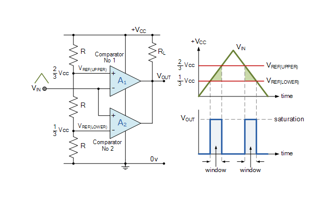

How do we know from the output that the two inputs are equal to each other?
If you use it as a linear amplifier in an appropriate configuration instead of a comparator (and it is properly calibrated), you can then see when the inputs are equal by reading it with and ADC, or using two comparators in a "window comparator" configuration.
Or it the "equality" is not too critical, just use two comparators directly, to get equal / greater / less output combinations.
Example window comparator. Make the difference between the two reference inputs as small as needed for the "equal" state.
Or use the two outputs separately and logic to determine equal or which is higher.
Note for that circuit to work you must use comparators such as LM311, 323, 339 etc. that have open-collector outputs.
As explained, with real parts, you can't.
When talking about analog circuits, there are two terms we never use: "exactly" and "zero noise"
You can never tell anything exactly and there is always noise.
You can tell the value or relative value of something within a tolerance if specified, and you can refer to noise below some limit.
I would set up your opamp as a differential amp. When the output of the diff amp is at, or near, zero, then the two input voltages are equal.
Set up the gain of the diff amp to be whatever is needed for the system requirements.
