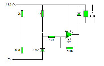

I have a refrigerator on my boat, and it takes a fair bit of current from the 12V supply. I would like to make a circuit such that it was only switched on when the battery was charging, say over 13.2V.
I think it would be best to use a LM311 comparator (datasheet **broken link removed**), but I'm not sure about the ancillary components.
One issue to consider is that when the relay fires, the load of the fridge will cause a dip in the supply rail. If there is not some form of damping, this will cause the circuit to switch off, then the voltage will rise, and the circuit will switch on ...
Any suggestions?

This will do the job.
What turn-off voltage do you require?
I've assumed about 12V.

Many thanks for that.
I hadn't considered that the turn-on and turn-off voltages could be different, and I'm not sure I want them to be. However, I guess it gets round the problem of oscillation.
I will do a test and see what the voltage drops to when the fridge turns on, and for how long...
