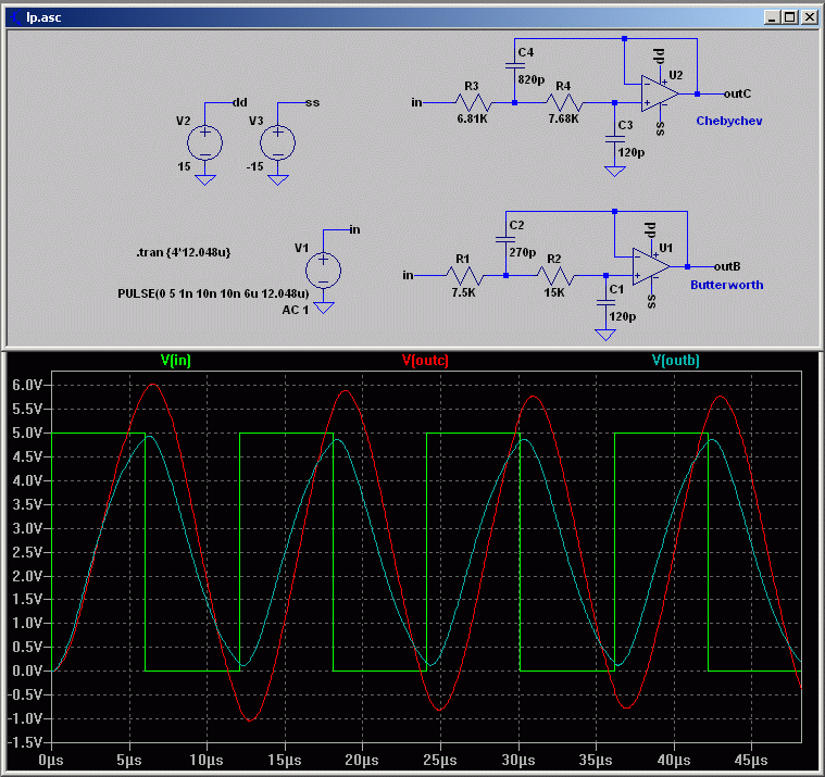

For example, if you generate a 5V square wave by loading 0 and 255 into your port every 6us (83kHz square wave), and then run it through a low-pass filter, here is what you get:

Didn't you learn that a squarewave is the fundamental frequency plus many harmonics? Then if you filter out the harmonics a pure sinewave remains.
One RC filter produces a gradual reduction of harmonics and might reduce the fundamental frequency a little. A Chebychev or Butterworth 2nd-order Sallen-Key filter made with an opamp as shown reduces the harmonics much more and leaves the fundamental frequency at a constant level.

Those are only 2-pole filters. 4, 6, and 8 pole filters are straightforward. Go to Microchip's web site, and download the free FilterLab software which helps you create your own filters.
A switched-capacitor lowpass filter IC can have an 8th-order (8 poles) filter. Maxim probably still make some.
To make my low distortion generator I used two 4th-order switched-capacitor lowpass filter ICs in series to make an 8th-order filter.
