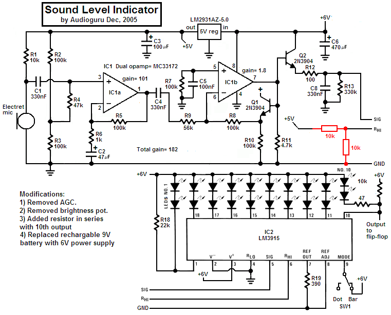

In my Sound Level Indicator project that has an LM3915 I use an MC33172 dual opamp designed with inputs that go all the way down to ground (a TL072 input fails if it is within a few volts from its negative supply voltage) and it works when the supply drops to 3V (the TL072 fails if its supply is less than 7V). Therefore my selected opamp does not need a negative supply and it still works when the battery voltage is very low. The MC33172 is similar to the LM358 (a dual version of an LM324 quad) but the LM has crossover distortion and poor performance above 2kHz and the MC has no crossover distortion and good response to 35kHz. Any of the new rail-to-rail opamps can also use only a positive supply.
I added an automatic gain selector so the LM3915 shows a range of 50dB instead of 30dB. My project is normally powered from a 9VDC wall wart but it also has an 8.4V (called a 9V) Ni-MH battery that is charged from the 9VDC.

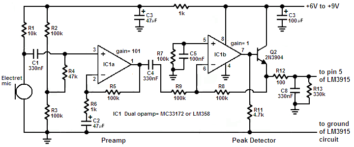

That looks like a nice circuit audioguru. I wanted to try an LM3915 with an electret mic as well at some point. Can I assume Q2, C8, and R13 make up the peak detector, or is the second opamp part of it to?

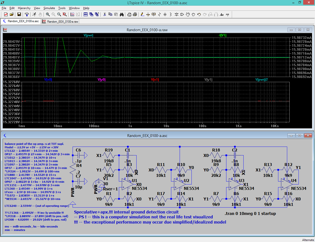

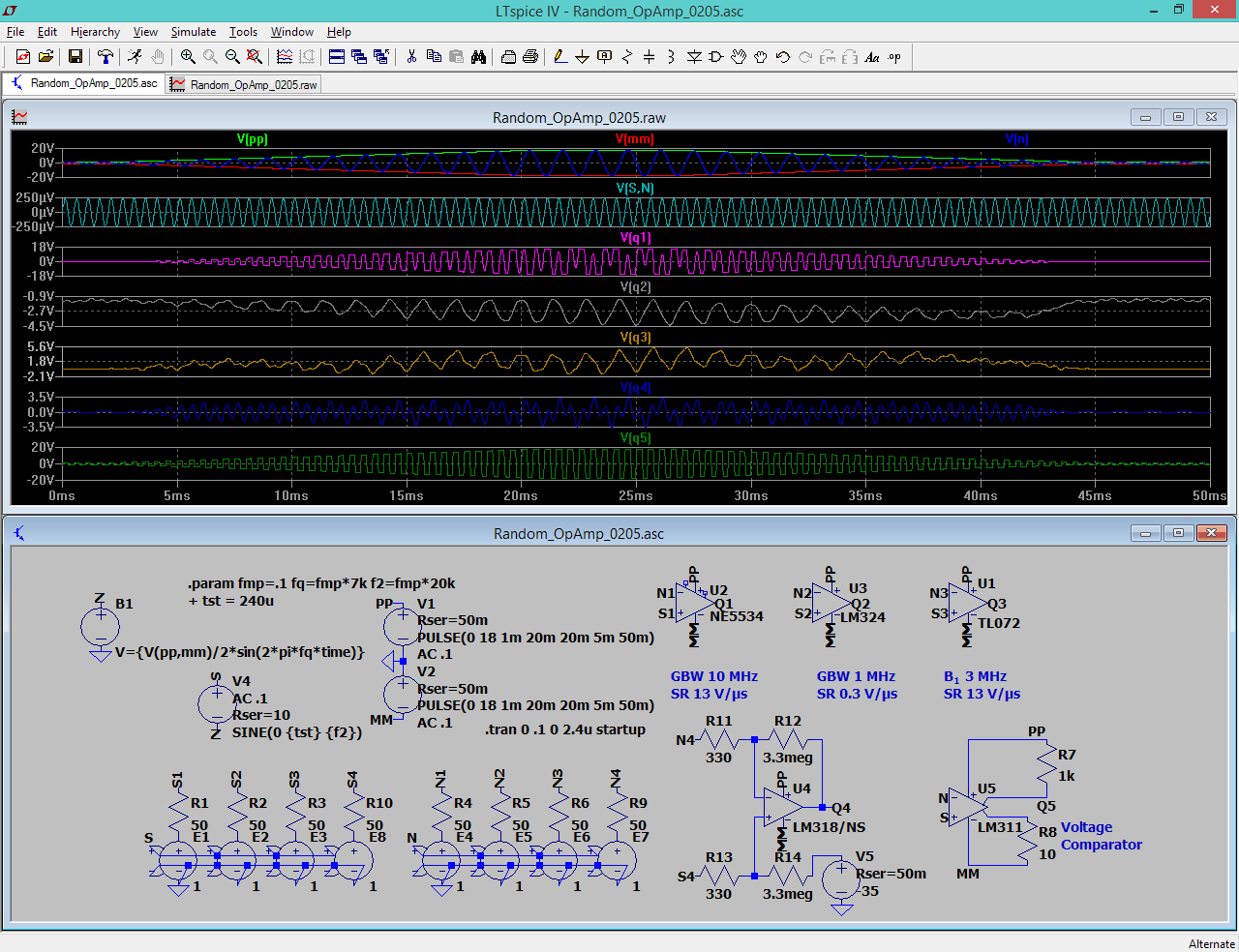

if i recall right then for the j-Fet input Op Amp the minimum Tot supply is 9.6V e.g. ±4.8V -- there it starts to respond as dif-amp but not yet operate . . .
most of op-amp.-s work best at specified voltages -- there with the full : -speed / -sensitivity / -slew rate / -e.c
the Spice test may be 10-s of times over-optimistic but for comparison it somewhat will do

Sorry, I posted a modification of my circuit. Here is a simple version of the mic preamp and peak detector:
