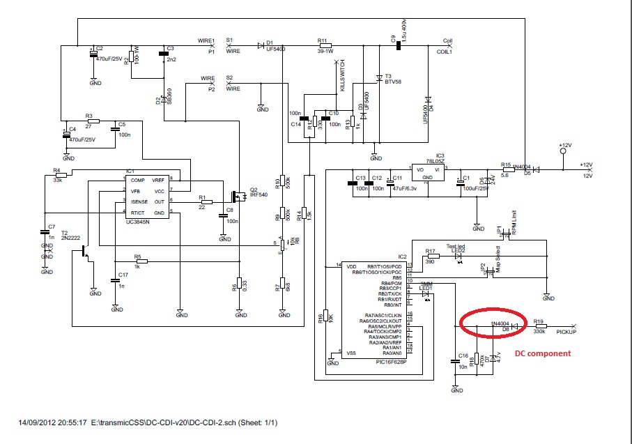

I dont know exactly what the results would be with each of these op-amps, One of the application is the DC- ignition system, when the pulse coil sends a pulse to the microcontroller, it is delayed according to the calculations and further send to the scr I have attached the schematics. So plz suggest me Which one should i go for RAIL TO RAIL CMOS lmc6482 or the regular ones?

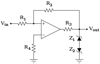

Hi

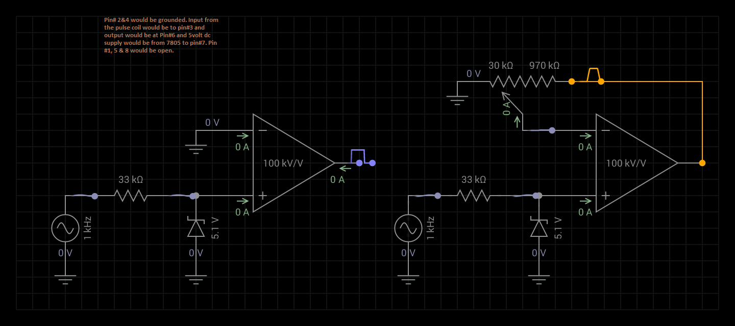

I have attached the schematics. So which op-amp should I use and how should be the connections. Plz explain in layman's terms

Most of your schematics use the opamp with positive feedback that is wrong. An amplifier uses negative feedback.

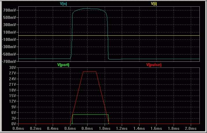

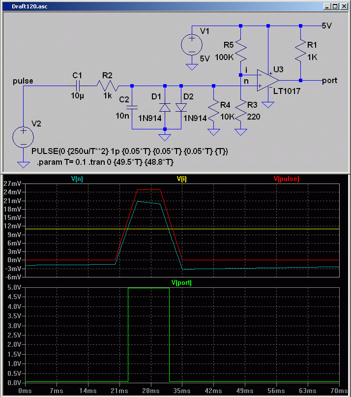

Here is a hack at it using a comparator. Two tests, one at 25mV at low pulse rate, and the other at ~25V at high pulse rate. It has input clamps to protect the comparator inputs.

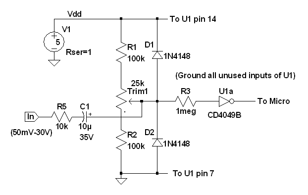

.... and here's another option, using a CMOS gate (it doesn't have to be an inverter as shown) with its input biased at the logic 0/1 trip point (~half the supply voltage) so that it is sensitive to small input changes (a few mV). D1/D2 clamp high inputs to the supply rails, and R3 limits gate input current.
What capacitor is c1? electrolytic or polyster?

Actually its a sine wave from the pulse coil. The negative pulse is removed and only the positive pulse is sent to the MCU. I have also attached the dc-cdi schematics. A diode is placed in between the pickup coil and the pin#10 of mcu. And when the +ve pulse is sent to the mcu, the mcu advances the timing as the rpm increases, i.e it delays the time between the in put pulse from pickup coil and the pulse going to the gate of scr. the gate of the scr is triggered on b4 few degrees i.e b4 the piston reaches the TDC to occur the spark and that too for some degrees only for the spark to occur.
other wise for the rest of the time there is no more pulse send to the gate of the scr during the complete crank rotation and the SCR doesn't conduct then

Since, per the links, there is no dc component in the pulse signal from the pick-up coil, you can leave out C1 in the circuit I posted back in #11.
Hi MikeML, I have attached the DC-CDi schematics. I have marked in red the dc component.
I meant "dc component" as "dc level". There is no dc level coming out of the pickup coil. You started this conversation claiming that the pickup coil produces 50mV at low rpm. 50mV will not trigger the PIC using the circuit you just posted.
Since the input signal is AC with no DC bias, the opamp input and negative feedback should be capacitor-coupled so that it does not amplify its own input offset voltage.
Not using an opamp; using a comparator, where the trip point is defined as a DC level. No capacitor is needed. Read the previous posts.
