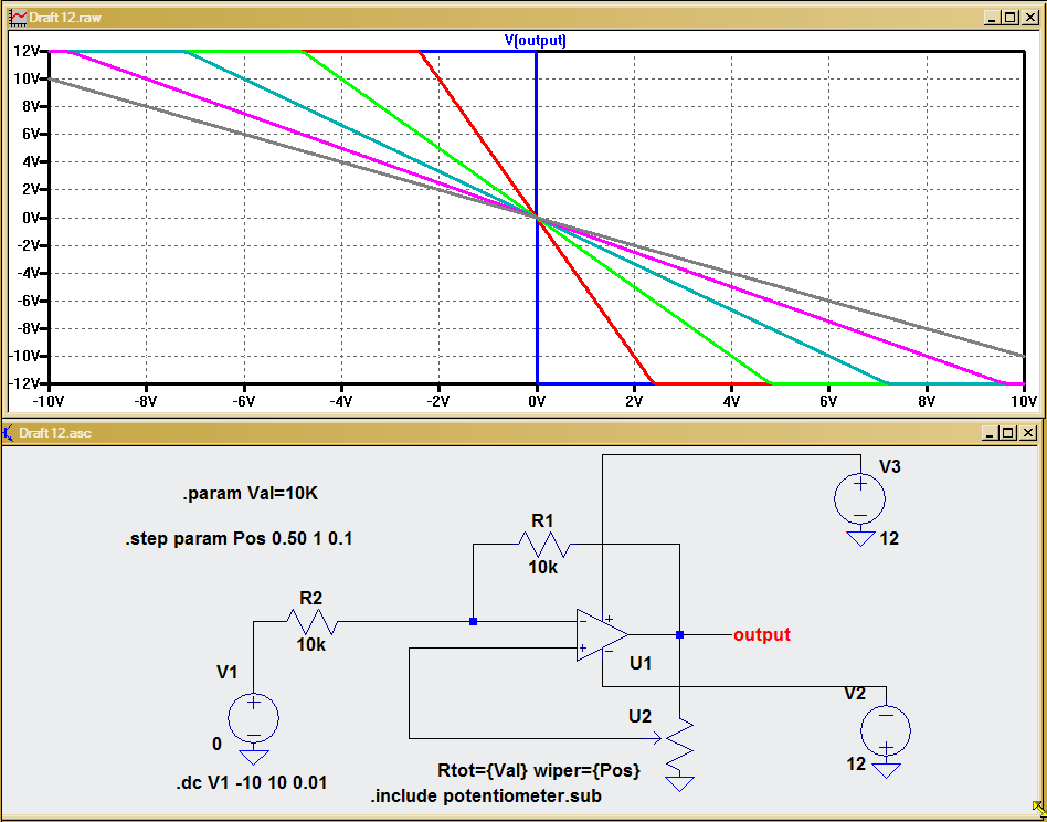

No you can't. With the wiper all the way to the bottom, the gain is -1. As the wiper is moved up toward the mid point, the gain gets progressively higher, but is always negative. With the wiper at the mid point or higher, the gain is -∞, so the opamp works like a comparator. The gain is independent of the value of the pot.

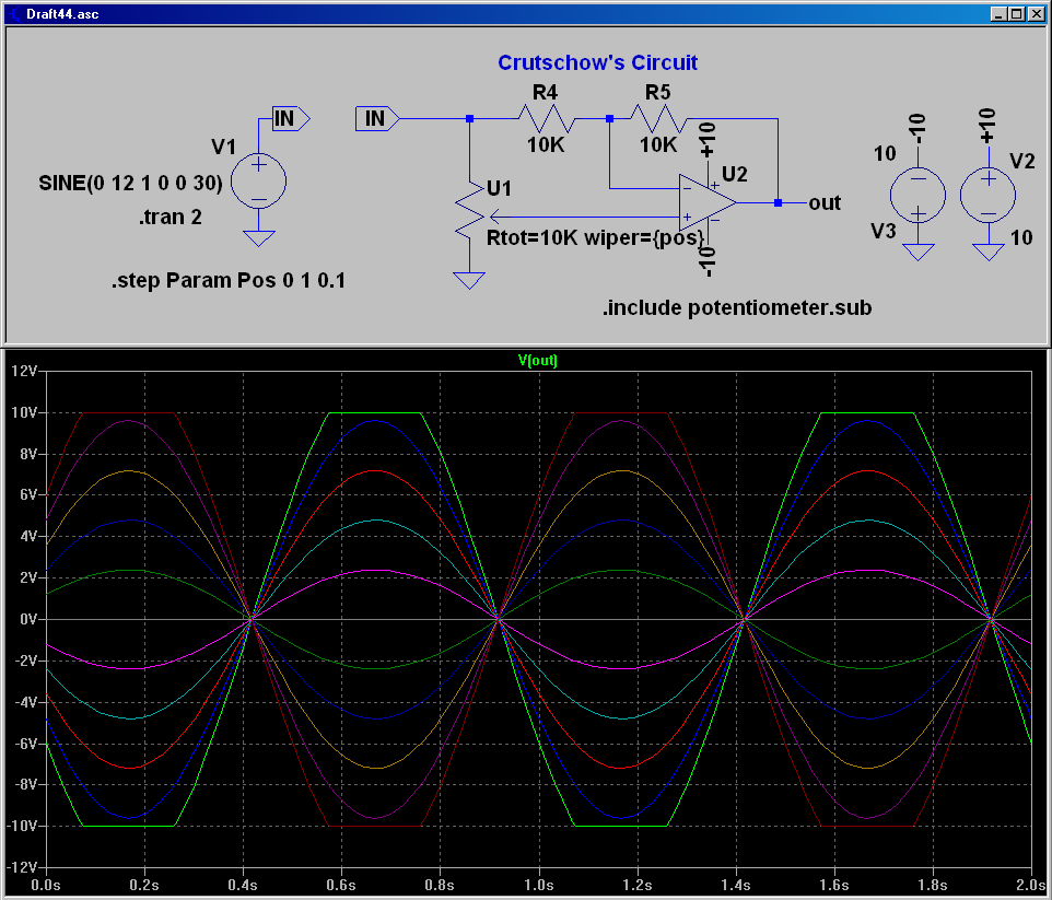

If you connect the wiper of the pot to the (+) input, one end of the pot to ground and the other end to the input source, then you can vary the gain from +1 through 0 to -1.

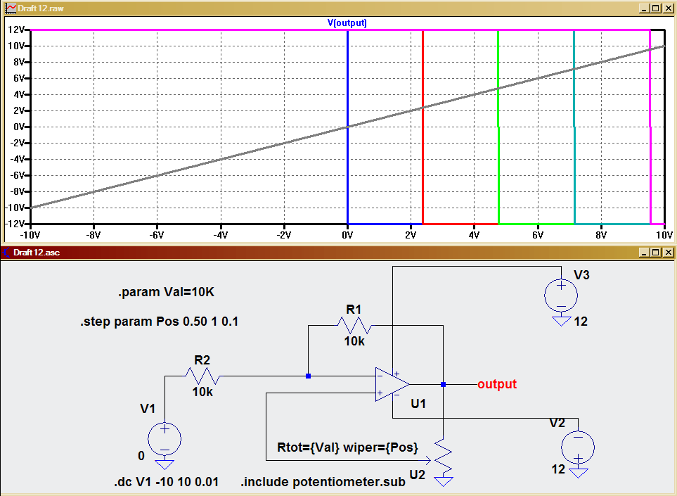

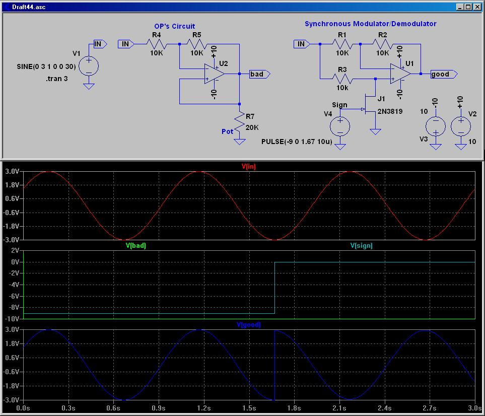

Practical considerations collide with theory. With the wiper at the end of the pot nearest the opamp output, the opamp output latches (acts as a Schmit trigger), and will not amplify the input signal by +1. Look at the sim.
Here is a Synchronous Modulator/Demodulator circuit which multiplies an input signal by +1 or -1 upon control of an external signal. Look at the sim.

You"ve got a positieve feedback , VO will be +Vcc or -Vcc. if Vo is positive and Vin rises V i will get higher and VO will collapse if its higher then V+ , defined by the pot.
Here is a sim

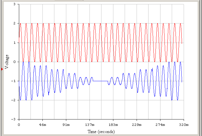

If you plotted the input versus the output, you would seen the gain inversion (180 degrees phase-shift) as you change the gain from +1 to -1.
Below is the graph for 10% increments in the pot. The plots were offset plus and minus 1V for better clarity.
If node 7 were grounded, it would be the bogus circuit that I simulated which latches. If you ground node7, and then move the bottom of the pot to ground, you will have the circuit suggested by Crutschow.
I believe you mean if you ground node 7 and move the top of the pot to the V3 output, you will have the same circuit I simulated.
