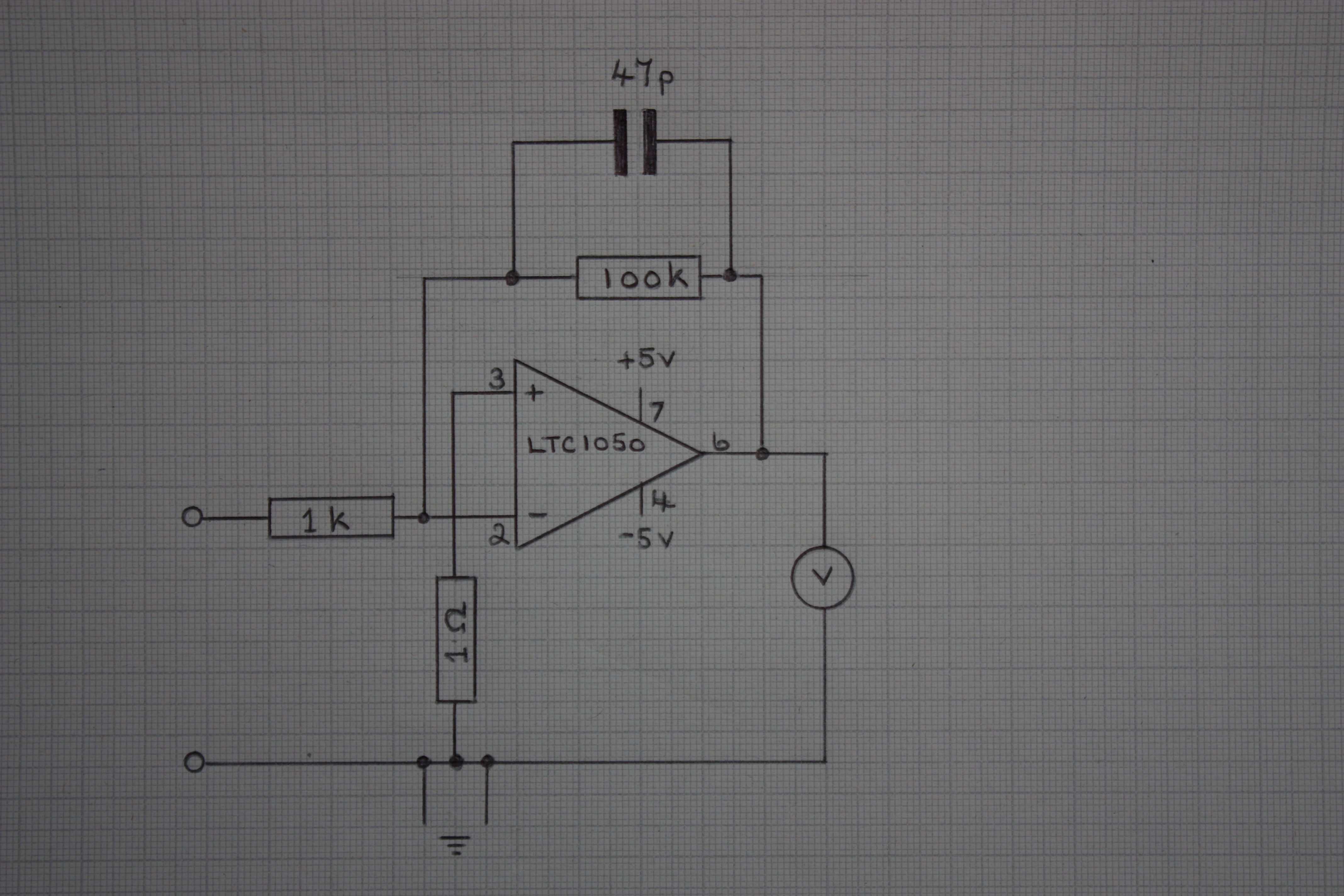

Hi Folks,
In the past I have made a few inverting op-amp circuits with gains of 10, 50 and 100, these have worked OK. One that had been working for 5 years had a copper track peeling so I tried to make a replacement. I can breadboard circuits that work but when I solder them up I have been getting erratic readings and the meter would not zero. The track did eventually break and I had no choice but move all the components to another part of the same board, in spite of the fact it had worked OK for 5 years it would not now work. The problem, I suppose, is thermocouples at the solder joints, but I wonder why I didn’t get this problem before. I have tried a few things to overcome this problem without success, the latest was to solder resistors and wires directly to the IC, cutting out the usual IC socket and using prototype board without copper pads or tracks. The meter fluctuates between zero and 1.2 mV initially. It does amplify 1 mV to around 100 mV but of course includes the initial offset. Any suggestions for a solution? – Many thanks.

Cant comment on your building techniques.
To minimize offset, the 1Ω resistor should be equal to the parallel combination of 1K and 100K. 1K*100K/(100K+1K) = 990Ω (1000Ω would be close enough).

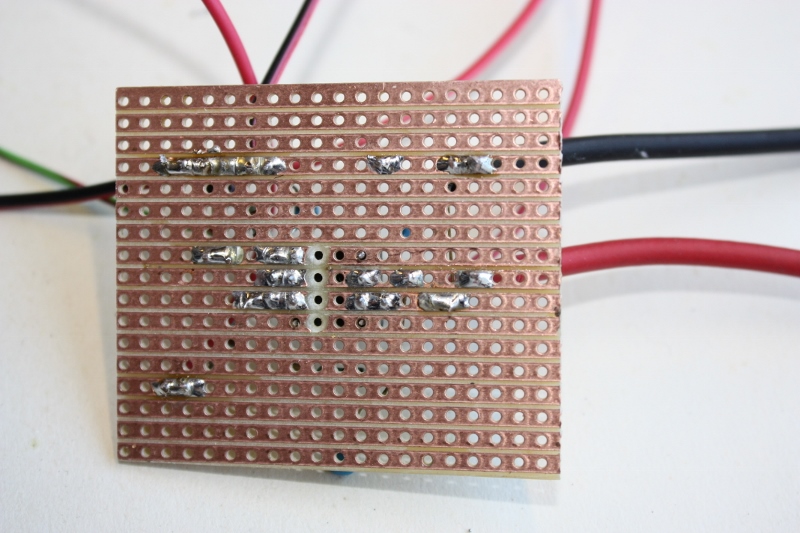

You might also take some pics of the actual board so we know what you are dealing with here. The board layout may be at fault or it could be something else more simple like mismatched resistor types.

with the 1 ohm resistor on the noninverting input, and 1k on the inverting input, you have offset from the unbalanced input currents. change the 1 ohm resistor for a 1k (910 ohms would actually be closer to balancing out the bias currents, but 1k will work). right now you have the bias currents impressing a voltage across the resistors, 150pV on one input (+) and 0.15mV on the other (-) giving 0.14995 mV offset at the inputs. multiply that by 100 and you get 14.995mV offset. this is using the worst-case bias current values in the data sheet, but you can see how this develops offset.

do you need a high impedance input or low impedance? are you using this as an electrometer, for something like Ph measurements? if so, an inverting amp isn't the way to do it. with the circuit as-is, you have an input impedance of 1k, because the inverting input is a virtual ground. from what you have said so far, even the tiny bias currents for this particular op amp will give significant errors, so to begin with you should change the 1 ohm for a 1k. yes if the input stage of the op amp undergoes sudden thermal shifts, your offset will drift a lot.

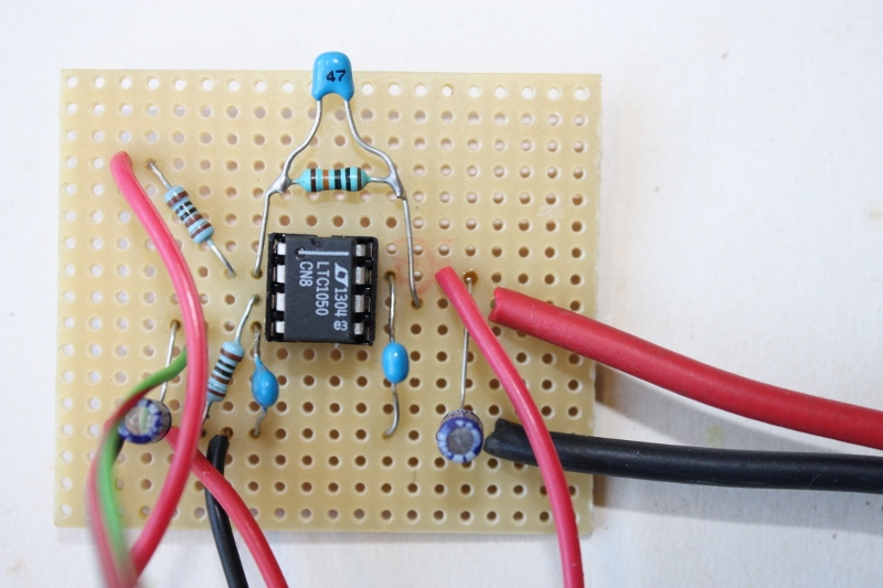

Power supply bypass capacitors are almost always necessary. For this particular kind of op amp they are even more necessary because it provides it's own internal clock and other circuitry used to stabilize the input offset. In many schematics however these caps are not shown, taking it for granted that the builder knows they are important.
0.1uf caps are usually the minimum, sometimes also paralleled with a 1uf or 10uf electrolytic. The data sheet might mention this also.
the 0.1uf bypass caps also should be placed right at the power pins of the op amp. a picture of the board layout might also be helpful here

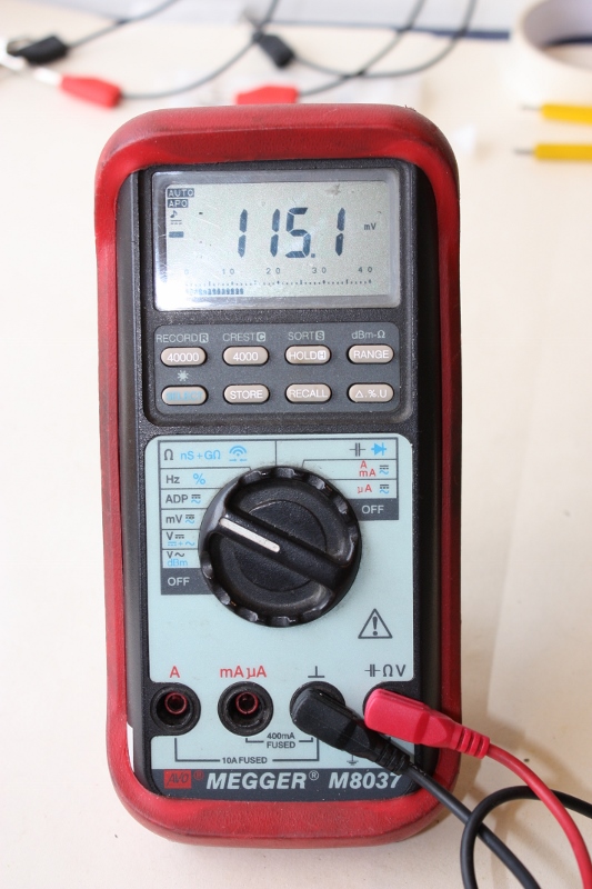

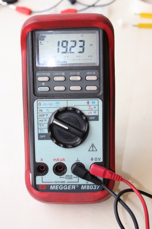

Hi Folks,
After building the circuit with caps, and with the op-amp on quiescence the reading on the meter was 22.23 mV falling slowly for about 15mins. to 19.23mV (would not zero). After inputting 1mV from a voltage divider the reading was a fairly stable 115.1mV. The gain was about 97 whatever the initial reading. Still no joy.
