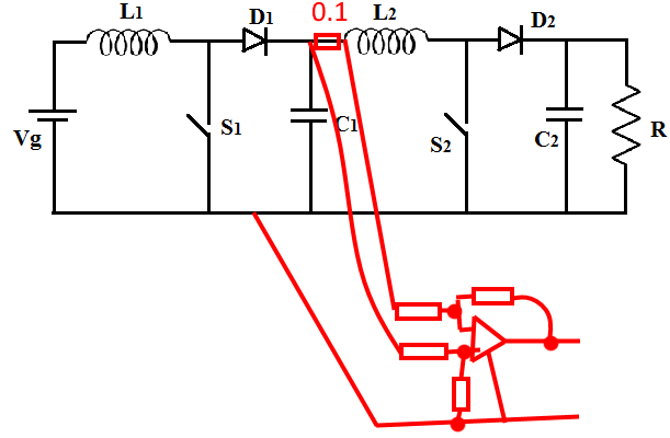

Circuit of my boost converter.
The 0.1 ohms resistor is placed before L2. So the op amp will measure the value(voltage) across the resistor using the differential configuration of an op amp.

What is the voltage at Vg, C1, C2? The amp needs to see the voltage at C1.

My Vg is 15V. For C1 and C2, I need to measure it at the classroom haha.
Anyway, At the duty cycle of 50%, I'm able to get 64V.
Vg=15 50% C1=30V 50% C2=60V Sounds right to me.

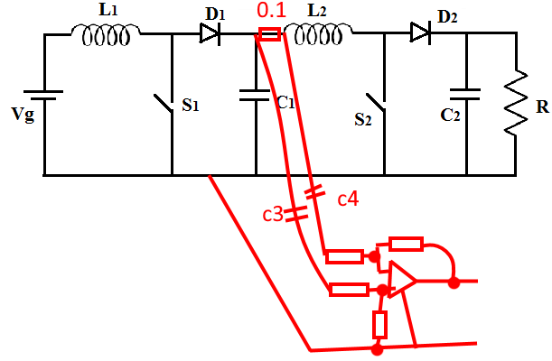

You are looking at 0.1V on top of 30V. So you need good 1% resistors.
The 30V might be above the supply voltage of the op-amp so: Add C3,4 to strip off the 30V.
C3=C4!
C3=C4!
How much of rating do you recommend for the C3 and C4?

Keep the resistors close to op-amp.
low frequency response = 1/2*3.14*R*C Size C for 3khz or 300hz of something well below your 30khz.
Choose a amp that is 10x faster than the 741. Do you know how?
Low Frequency Response = 1/2 * 3.14 * R * C
So I select my the low-frequency response myself and calculate the value for C? How about R? Where do I get the value of R .

1k for the input resistors and 10k for the feedback resistors. 1k, 1k, 10k, 10k

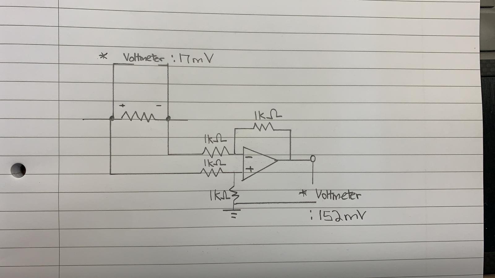

Can I ask another question?
Why do I get this? Shouldn't I be getting the same value? Op Amp 741
The resistor is connected to the same dc-dc boost converter circuit as we were talking about.
I'm thinking practical op-amp is not ideal as compared to theory? That's why there is a gain of 10~ even using a unity gain amplifier configuration.

Opamps have "input common mode voltage range" in the data sheet. That is the voltage where the amps works. The ua741 should have the input voltage about 3 volts away from the supply voltage. So a supply of 15V and 0V will work with input voltage of 3V to 12V. That is why if is common to have a negative supply to work with voltages near ground.

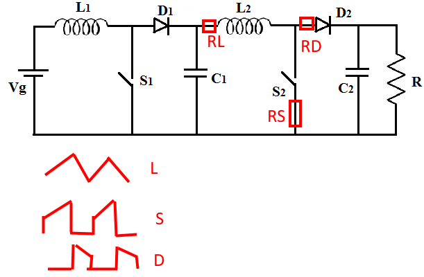

Measure the current at RS and you can almost see the current at RL. It might be easy to see RS. It is at ground so not 30V to get rid of.
